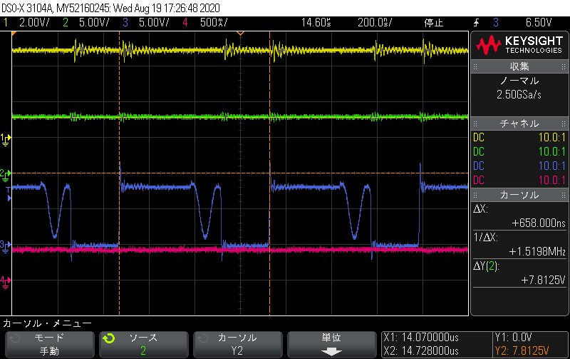

The condition of default bq25886EVM and no battery connection (and no thermister: only 10kΩ), system current could only up to 350mA.
When system current over than 360mA, maybe occur current limit and Vbat decrease, waveform is attached below.
When bq25886EVM use on high current condition, is there changes point from bq25886EVM default setting?
Or, is 350mA limitation normal operation on no battery condition?
※ch1: VSYS, ch2: VBAT, ch3: VSW, ch4: ISYS

  • Ricardo-san
    I update information, please see below;
    When I changed only JP12: open and JP16: 8.2Vset from EVM default value, Isys became 420mA_max and maybe Iin clamped 455mA.
    I captured Vbus (Yellow), Vsys (Green), Vsw (Blue), and IVBUS (Pink), please see attached below.
    ①Isys: 0A
     Phenomenon: Unstable and STAT pin blinking 1Hz
    ②Isys: 50mA ~ 200mA
     Phenomenon: Unstable and STAT pin blinking 1Hz, and occur strange noise
    ③Isys: 270mA
     Phenomenon: Stable and STAT pin: High, IVBUS clamped 455mA and VSYS decrease 7.8V
    ④Isys: 350mA
     Phenomenon: Stable and STAT pin: High, IVBUS clamped 455mA and VSYS decrease 6.0V
    ⑤Isys: 470mA
     Phenomenon: Nearly 100% Duty operate, IVBUS is roughly same as ISYS, VSYS decrease 4.5V
    ⑥Isys: 550mA
     Phenomenon: Nearly 100% Duty operate, IVBUS is roughly same as ISYS, VSYS decrease 4.0V
    ⑦Isys: 720mA
     Phenomenon: Could not capture because Electric load occur reverse current protection
    Please let me know if there anything points and advice.

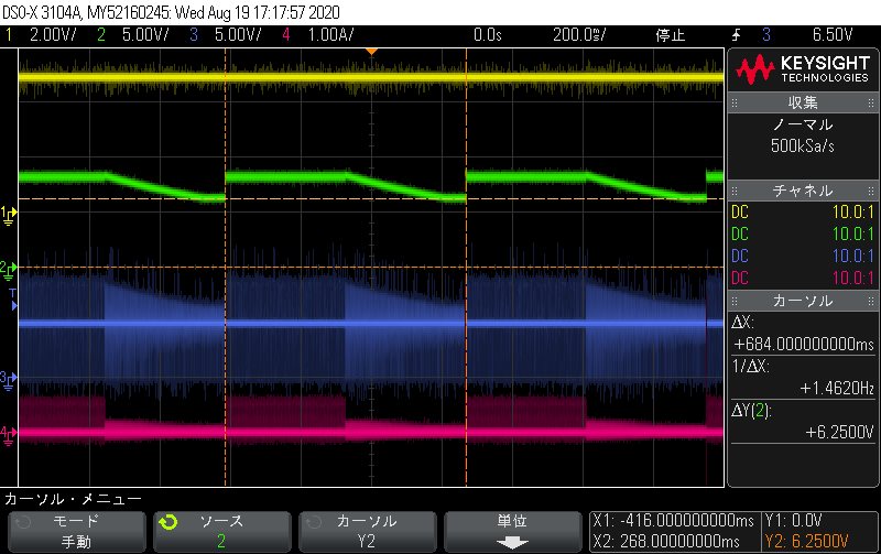

  • Ricardo-san
    Thank you for advice,
    I re-measured correct Load and D+/D- condition, please see update below;
    ・Input current is set enough, DC supply set 5A_max and clamped about 1A by D+/D- setting.
    ・VBUS is based on 5V.
    ・When VBUS increase to 6V, problem waveform is attached below.
     VBUS increase or ISYS decrease have a tendency to occur below waveform.
     For example, border are 5.3VBUS and 590mA_ISYS, 5.6VBUS and 640mA_ISYS, 6.0VBUS and 700mA_ISYS
    ch1 (Yellow: VBUS), ch2 (Green: VSYS), ch3 (Blue: VSW), ch4 (Pink: Iin)
    Satoshi
  • Satoshi-san,
    Shorting D+ to D- will set your current limit to 3A.
    Ricardo
