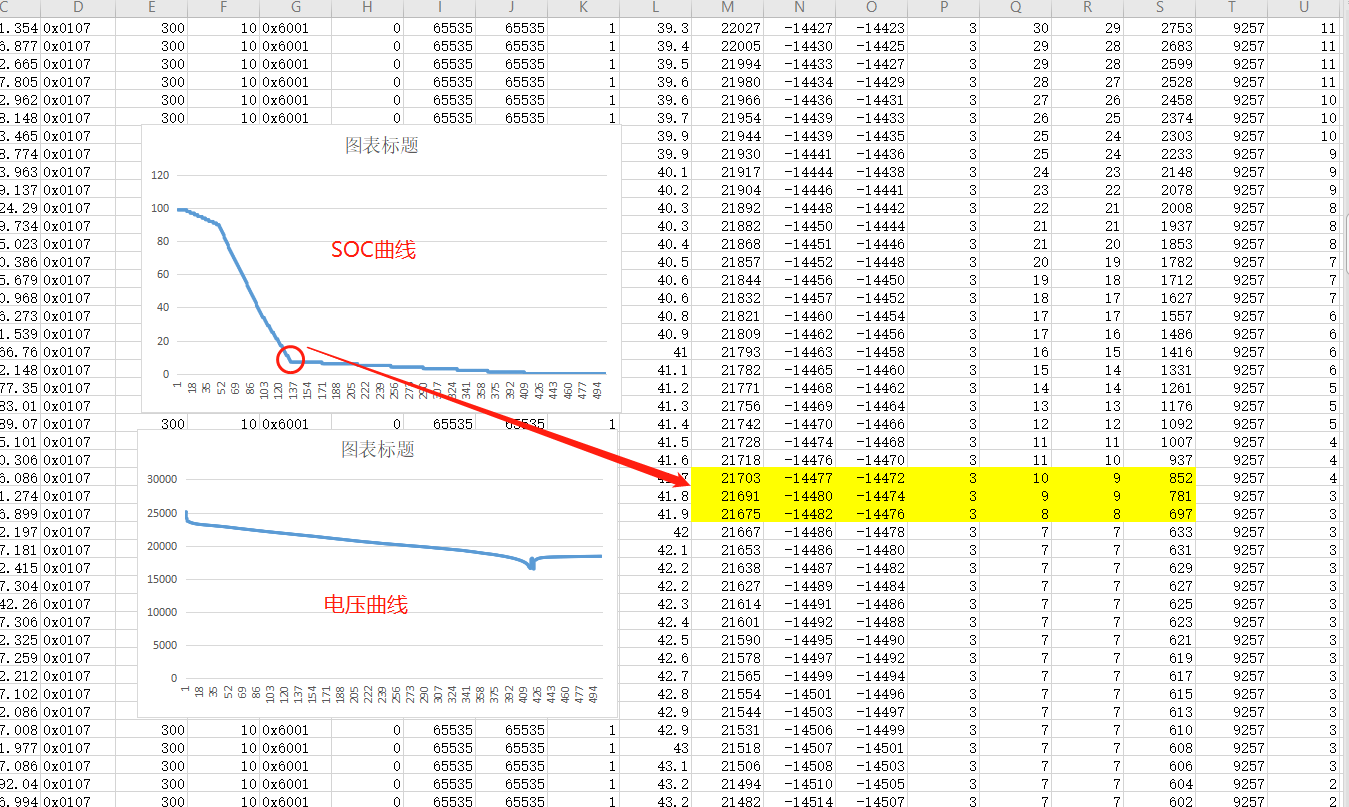

My customer tests with 6S6P battery packs using BQ40Z80.
When performing high current discharge (greater than 25A), RSOC quickly dropped low (about 9%), and then 9% to 0 remained for a long time (DSG_SMOOTH is turned on).
Which causes the RSOC display inaccurate, and the RSOC display is normal when 0.5C (about 10A) discharge.
How to solve this situation?
