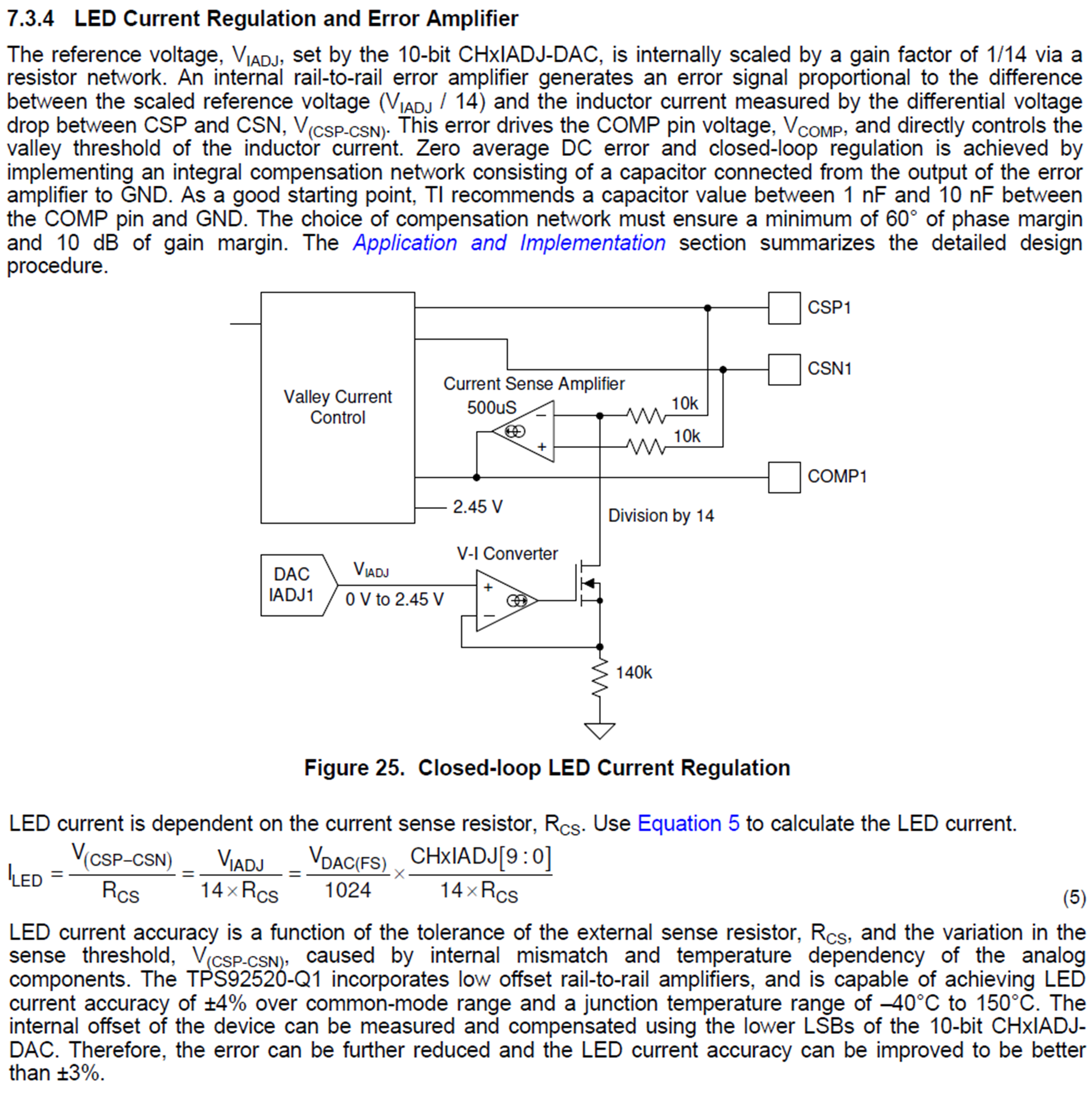

4. When setting the value of current using register of IADJ, is there any equation of calculating the current?(Or just using Hex value?)

    4. The LED current is set by a few things and is covered in the datasheet in section 7.3.4 and section 8.
