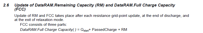

As you can see in the graphic the FCC changes many times (not big changes but one peak that raised almost 200mAh) when battery is at 100% SoC. Looking at the document when IT algorithm is explained I can read
However, none of these conditions (resistance grid-point, exit of relaxation or end of discharge) are fullfilled.
1. Why is FCC changing with so high frequency?
2. Is due to FCC simulations?
    The FCC value calculated is based on the equation you linked, the gauge updates this value more often than each grid because many things determine FCC. Because there's only 15 Ra grid points the gauge runs simulations more often than 15 times per cycle based on the temperature change and voltage change.
    Let me know if you have any more questions!

    1. I would like to know the exact conditions under BQ34z100-g1 do Capacity Simulations. This is very important for us to understand the behaviour of the fuel gauge in our application.
    2. Why do you think changes in FCC are more visible when SoC is 100% (but FC is still not achived)?
    3. What do you think might be the reasons for the peak in FCC you can see in the 2nd graphic (almost 200mAh increase)?
    There are many conditions that the gauge will run simulations, I don't believe this is in the documentation and may be confidential. The gauge will constantly be updating FCC when other parameters are changing. The gauge updates RAM with new values every 1 second, this is the minimum time interval between when simulations could be run.
    If there's still current flowing in the gauge when it reaches 100% SOC it will be trying to correct for this.
    I believe that may be erroneous measurement, either by the gauge or in the communication.
