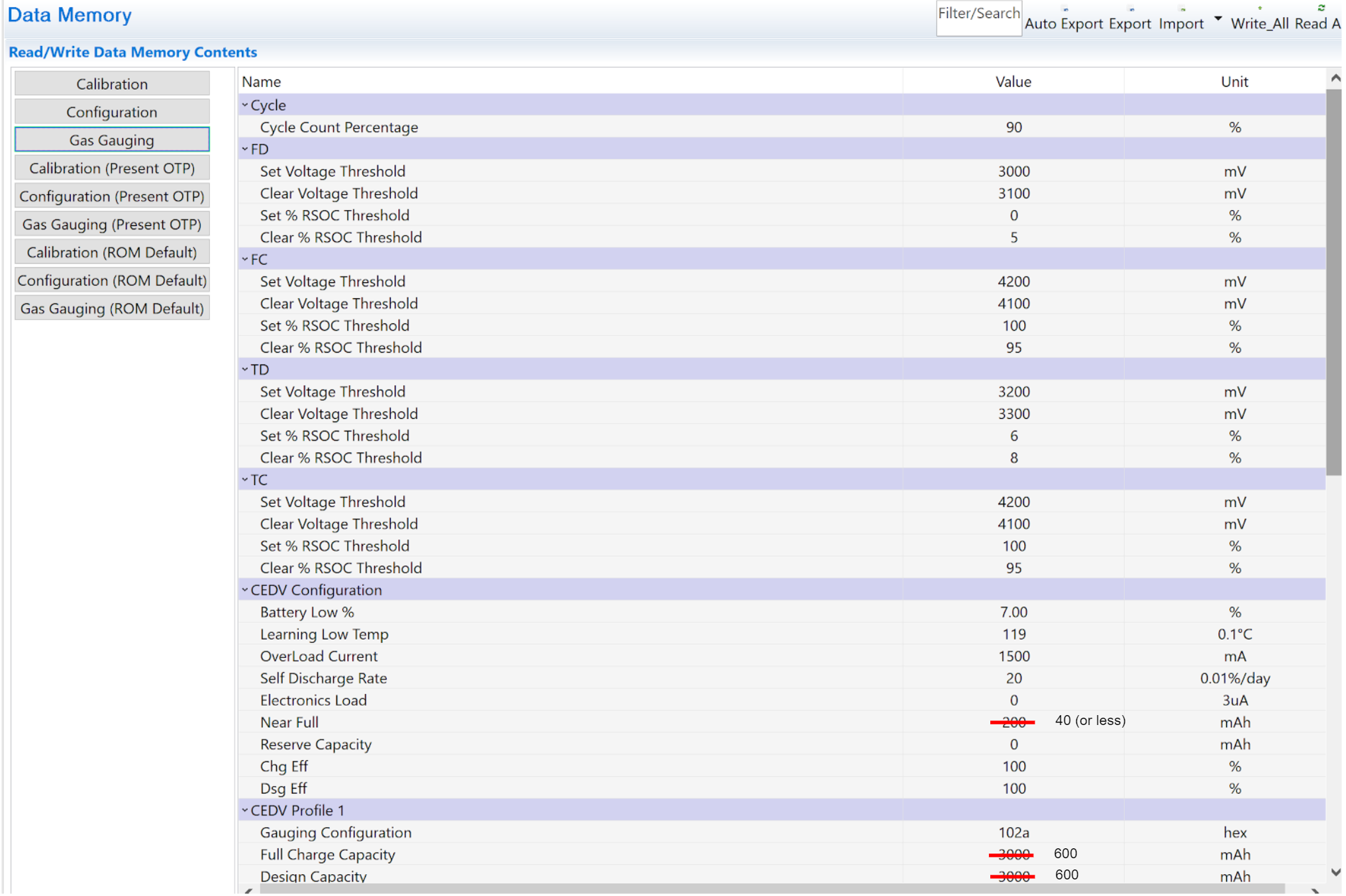

    Thank you for your response. What you're describing is precisely what we have done. We used the EVK to generate a custom .fs file with parameters such as design capacity (600mAh), near full, etc modified to match our system. This new .fs file then gets programmed into the gauge by our processor on boot. We have already verified that the file is being loaded correctly and all the verification steps are passing.
    The question now is, when we read the FCC register, we still see the default value of 3000mAh. Looking at the screenshot I posted, I am understanding that in order for the FCC to go from this default 3000mAh to 600mAh, it will take a little over 9 qualified discharge cycles since FCC can only reduce by 256mAh per cycle. Is my interpretation of this correct?
    The issue is that even after loading our custom FS file onto the BQ27220, we are not getting accurate readings for battery percentage. Remaining capacity readings are also sometimes in the 2000 range, indicating that the gauge is still working with the default capacity of 3000mAh. When we read back the design capacity, however, we see that it is correctly set to our 600mAh.

  • Hello Vignesh,
    Could you export your .gg file so we can see your settings?
    You can set the FCC value manually in the gauge in dataflash , it is right next to design capacity in bqStudio. You may need to do this to get an accurate reading from the beginning of gauging.

  • Hi Wyatt,
    We have set the FCC value manually in dataflash. Here is a screenshot from bqStudio that we used to generate our FlashStream file:
    As you can see, we are updating the value of Full Charge Capacity to match Design Capacity. After the FlashStream loading is completed, when we read back Design Capacity using the standard command 0x3C, we correctly get 600mAh. However, when we read back FullChargeCapacity using the standard command 0x12, we still get 3000mAh. Is there anything that we're doing wrong?
    Vignesh
  • Hello Vignesh,
    Is this screenshot after the .fs file was loaded to the gauge? If you have loaded the .fs all the dataflash should update to the values you programmed in the .fs, you wouldn't need to cross them out. Are you in unseal full access mode of the gauge? If not you may not be able to write to these registers and you will have to put it in full access mode.

  • Hi Wyatt,
    The screenshot is just a reference to show what changes we have made for our application compared to the default values from the fuel gauge. This was taken using the EVK, and the generated FlashStream file (attached for your reference) is what gets successfully loaded onto our fuel gauge on our PCB. The file is fully loaded successfully, as seen by checking the return value of the gauge_execute_fs() function. Right before this function is called, we are putting the fuel gauge into full access mode by writing 0xFFFF to register address 0x00 twice.

    The issue is that even after this attached FlashStream is loaded, the value of Full Charge Capacity (read back using standard operating command 0x12) is still 3000mAh. The value of Design Capacity (read using 0x3C) is, however, correctly updated to 600.
    I know you asked about the .gg file in the other post, would this be beneficial in helping us debug this? I can connect to those lines on our hardware and see if I can use Battery Management Studio to extract the .gg file if so.

  • Hello Vignesh,
    Okay I see what you are showing now, thanks. The gauge should correct the FCC value after the first full cycle, when the design capacity is changed. Are you seeing that this is not the case after the first cycle? The gauge needs to go through a full cycle in order to update the FCC.
    Yes if you could log the cycles showing the FCC is not adjusting correctly and export the .gg file this would be the best for debugging the problem.

  • Hello Vignesh,
    1. Full cycle is charge to full, relax 2 hours, discharge to terminate voltage, relax for 5 hours. You can also refer to GPCCHEM.
    2. You will need to have configured GPCCEDV tool, then start testing in the product to determine if the golden image is acceptable.
    3. bqStudio should export the gg file. It is in the EVM user's guide.

    Thank you for answering those questions. I want to clarify the GPCCEDV tool process just to ensure that I'm understanding correctly:
    First, we will perform battery characterization using the GPCCEDV tool and send the data as a zip to TI. TI will email back a report with which we load the "golden image" onto the fuel gauges.
    Is there a guideline on what the battery characterization process should look like on our end?
    What is the golden image? Is it similar to a FlashStream file, and loaded the same way?
    Once we obtain the golden image, will each device's fuel gauge still need to go through the full cycle (i.e. 7+ hours) before it can be shipped to a customer?

  • Hello Vignesh,
    Yes, the zip data is just a collection of CEDV parameters in which you program the gauge. The golden image is the flashstream file, except it is just an image in RAM. It's loaded via the same way as you would any other fs file. Please refer to the TRM on how to change parameters.
    The golden image can be shared and can be programmed via a host controller. We have an app note, gauge communications that shows how one may do this.
