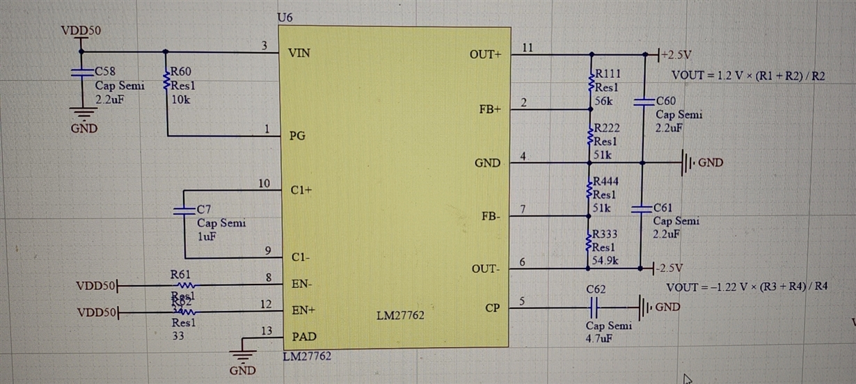

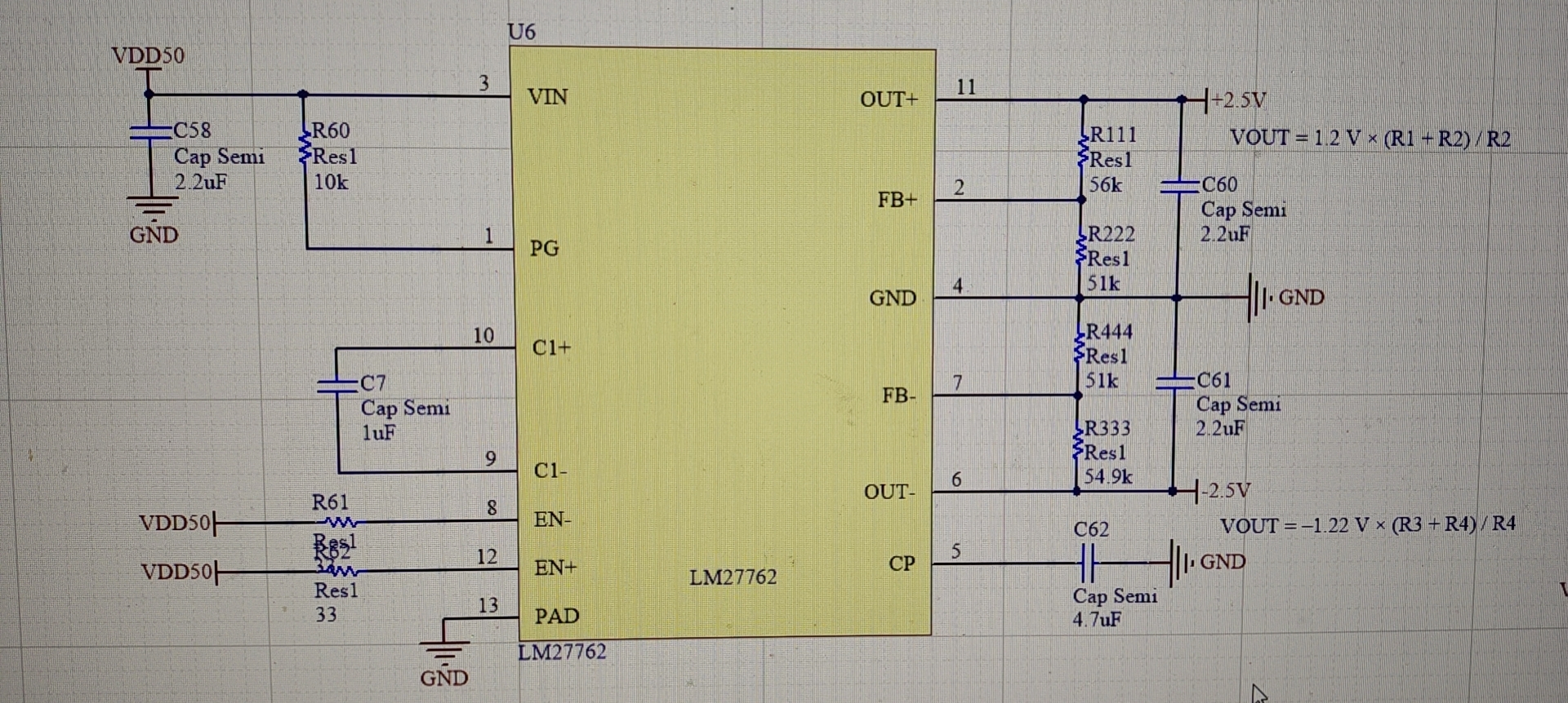

LM27762: the output of -2.5v is only about -1.6v, and powergood is always high
Part Number: LM27762
Dears
The input voltage is 3.9;
When there is no load, the output of -2.5v is only about -1.6v, and powergood is always high.
When this phenomenon occurs, the voltage of FB-PIN is -0.8V, and FB- is -1.22V in the specification when it is normal.
How can there be ±2.5V output;
Below is the circuit schematic
