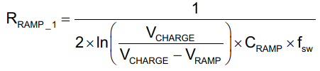

  • The issue is as below:-
    Vref=3.3
    Vpre_bias= 3
    Vsr_ramp=3
    Vramp  = Vref – Vprebias      x Vsr_ramp         = ( 3.3 – 3 ) x 3 = 0.3 / 2 = 0.15
                       2 x Vprebias                                                        2 x 3
    Vramp=0.15 V
    Considering C = 100pF (as in SLUU441A)
    Vcharge = Vref = 3.3
    Fsw = 200kHz
    Rcs = 1 / [   2 x ln{ Vcharge / (Vcharge – Vramp)} x Cramp x Fsw ]
    Rcs = 1 / [ 2 x ln( 3.3 / 3.15) x ( 100 x 1e-12 ) x (200 x 1e3) ]
    Rcs = 1 / (1.86 x 1e-6) = 537403 Ohms = 537 KOhms

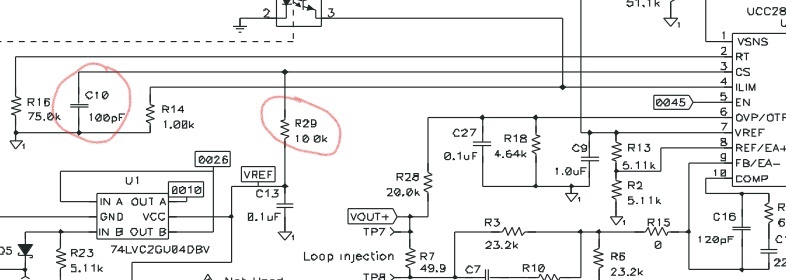

    Where as in SLUU441A Rcs is 100K or 10K i am not sure
  • R29 can be found in the user's guide from BoM, it is 10k.
    So the design did not pick up Vpre-bias = 3V, and should be < 3V. I do not know exactly what Vpre-bias picked up for that design. But if you pick up 3V, then you can just use the calculation results you obtained. If you want to match that design, you need to pick up a different number.
    Actually you can use equation (29) as is, and plug your Vin, n, to determine Vramp. After you estimate Vramp, you will get a corresponding Rramp.
    You even can make a Vramp arbitrary. The critical thing here is Rramp. After Rramp is calculated, the Vramp is actually backwards achieved.
  • I back-calculated and got Vpre as 1.09V for C=100pF and R=10k
    The thing is that I normally like to know why I am using the components as well :)
    Thanks for your support. If you can show some more light on this in the future I will greatly appreciate it.
  • I think you can back calculate equation (29) as is, i.e., with your Vin and n, and with Vpre-bias = 3V.
    As it looks to me your design has no pre-bias, so the calculation for your design has more options. But if your design does have a pre-bias, equation (29) should be used as is.
