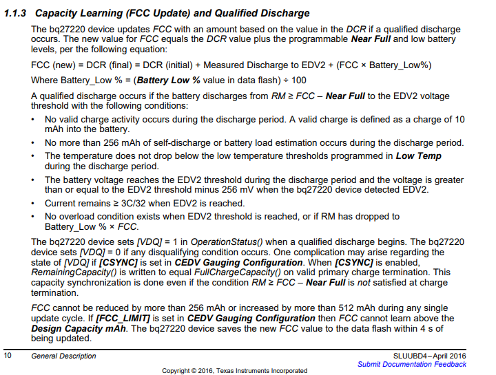

Debugging the BQ27220 fuel gauge on our product and I ran a quick test to try and capture charge/discharge cycles. I ran an overnight test with the device discharging and monitoring the VDQ bit, per this snippet from the reference manual:
When I came back to the setup this morning, I found through the UART logs that the VDQ bit had not been set. The battery had hit 0% and shutdown, but VDQ remained at 0 the whole time. The only bit I saw change in the OperationStatus() register was the EDV2 bit, which should get set when below the EDV2 voltage threshold, i.e. 3.501. Note however that based on my logs, this bit actually got set at around 3.616V based on the fuel gauge's voltage reading.
When does a qualified discharge begin?

    Thank you for your response. The photo was just a screenshot from the reference manual; I have attached it here for reference.

    If you have done a full cycle the VDQ should be set when you start to discharge, did you do a full charge before discharging?
    The condition for DCR are explained in the TRM:
    Discharge Count Register (DCR) —
    The DCR counts up during discharge, independent of RM. The DCR counts discharge activity, battery load estimation, and self-discharge increment. The bq27220 device initializes the DCR at the beginning of a discharge to FCC – RM when RM is within the programmed value in Near Full. The DCR initial value of FCC – RM is reduced by FCC/128 if [SC] = 1 in CEDV Gauging Configuration and is not reduced if [SC] = 0. The DCR stops counting when the battery voltage reaches the EDV2 threshold on discharge.
    You may need to adjust your Near Full value to get a valid discharge.

    Yes, I did do a full cycle charge before starting to discharge. We have already set our Near Full value to 40mAh for our 600mAh battery. What other values are relevant for the BQ27220 to detect a valid full charge?

    You will need to refer to the primary charge termination conditions in the TRM for valid full charge.
