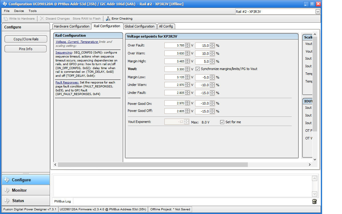

I am using UCD90120A to manage my power sequence and monitor my power supply status, I set the lowvoltage threshold for monitoring.
I did a test, I shortcut the 3.3V and 1.8V to GND, I expect it  de-assert power good signal, but I did not see it happen. The power good signal is still there.
I attached the UCD90120A configure file here.

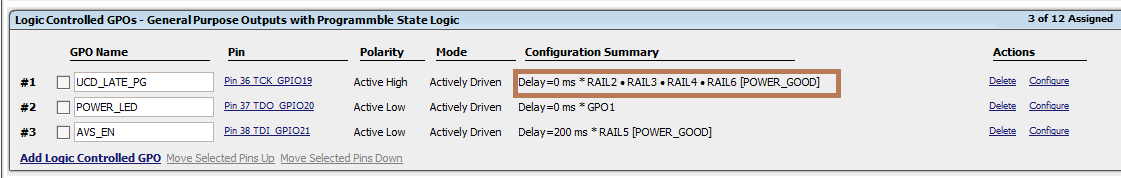

    Which exact signal(pin) do you expect to be de-asserted?
    If you want to deassert POWER_LD or UCD_LATE_PG signal, you have to include rail2(3V3) and rail3(1V8) into the logic.
    If you expect short 3V3 and 1V8 to turn off other power, please set the proper fault response.

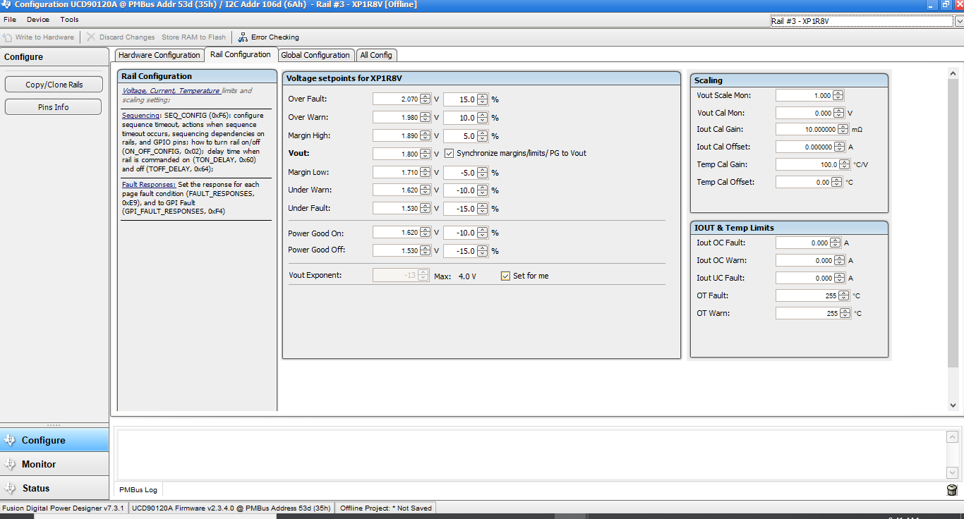

  • Yihe,
    Thanks for answering.
    I want de-assert power good signal when it drops under a threshold, only want a signal, an FPGA will get this signal and take actions.
    I configured the threshold like belowing, is it enough?  need I do anything else? other configuration or coding needed? If you are in China, Could you give me your phone numer for easier communication?

  • Hello
    No, changing thresholds does not help you. You have to include the rail2/3 into the logic of the POWER_GOOD as shown below
    Please contract Oliver Ou who is your local FAE.
