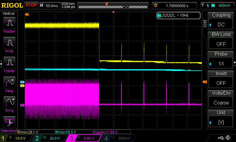

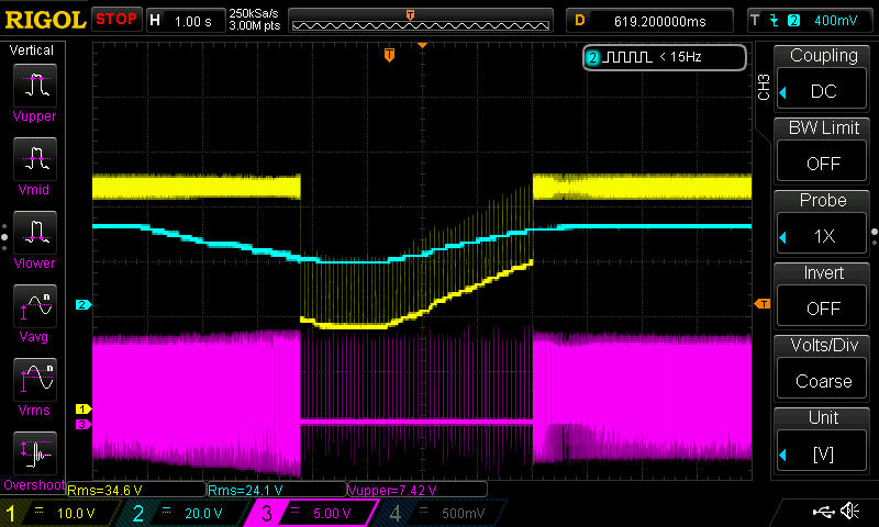

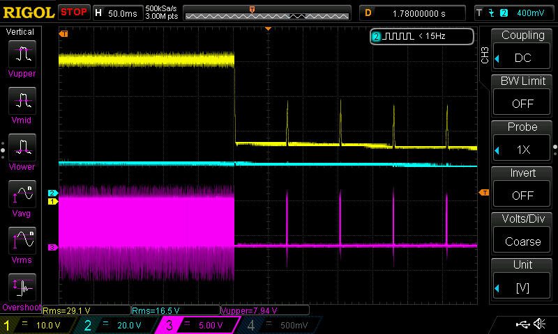

    C4 was replaced, but nothing changed.I am also testing the lm5121q circuit (it works correctly)and its compensation circuit is: C4 = 330p, C5 = 33n, R2 = 13k.
    I used the same combination of parts for lm 51551-Q1, but without change.
    edit:
    when I increase the output current.
    Figure 1.
    When I increase the input voltage.
    Figure 2.
    When the input current exceeds 6.6A, the output voltage drops to the input voltage.
    Peaks at gate pin: Mosfet tries to start.
    Figure 1.
    1-Output voltage
    2- Input voltage

    Figure 2.
    1-Output voltage
    2- Input voltage
    3-Gate
     Michael
  • Hi Michael,
    In your application is the LM5155 or the LM51551 being used? It looks like the device is running into peak current limit. I suggest measuring from CS to GND to see if the peak current limit is being exceeded.
    If that is the case please decrease the current sense resistor. Note the LM5155 quick-start calculator can be used to double check the other component values.
    Garrett
