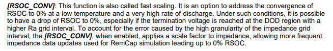

There is much information about Fast Scale Load select in the R3 TRM.

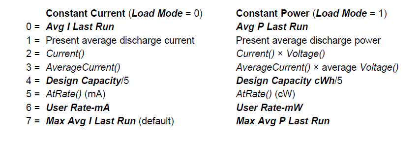

1.May I know the bit definition for Fast Scale Load select? Is it same as the load select?
2. Since the fast scale load select would only apply when the fast scaling active, can the users set Fast Scale Load select and Load select differently?
