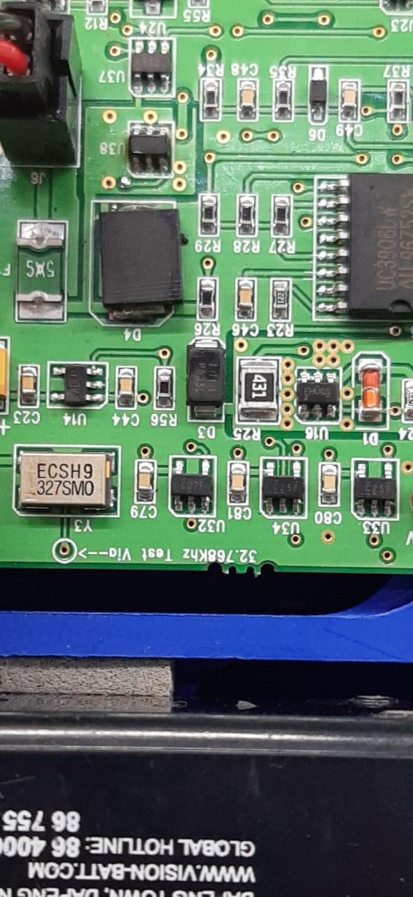

I have come across Parts with Device Marking "EHUG9", AGLW7, LTA2, and a few more, I would like to know how to find the Actual Part?

Hello James,
Using the Part Marking Lookup Tool: http://www.ti.com/packaging/docs/partlookup.tsp#divline , I am not able to find any TI device. Please send a picture of the device.

Sir,
Here is the attachement

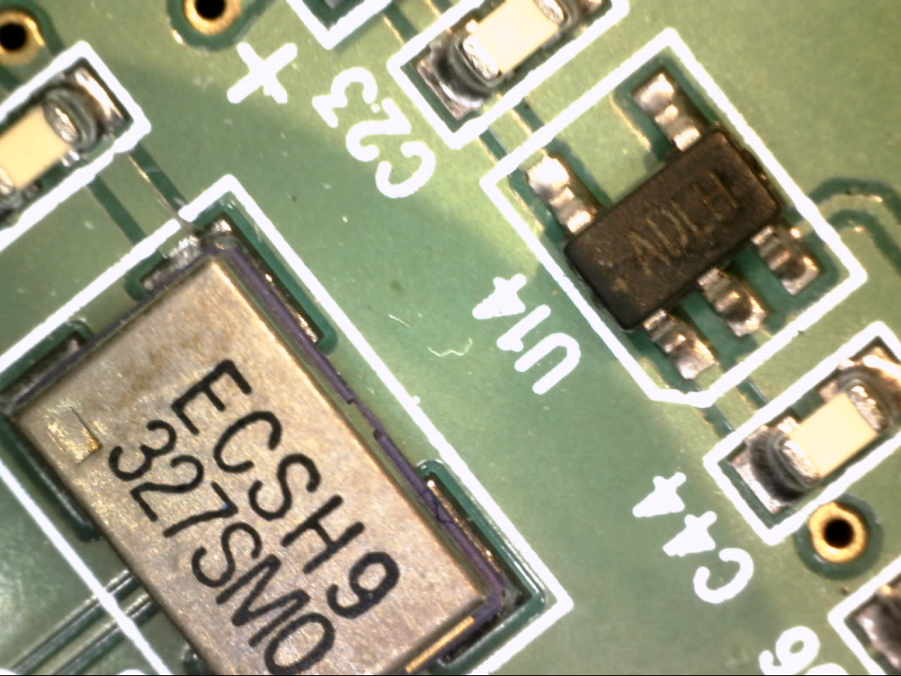

Hello James,
Thanks for the picture, but there is not enough resolution to read any markings. Please take a closer picture of the device(s) you are asking about.

Hello James,
These are not Texas Instruments devices. Suggest you contact the product manufacturer and ask for a schematic of the board. That way you will have the IC part number, regardless of the marking.
~Leonard

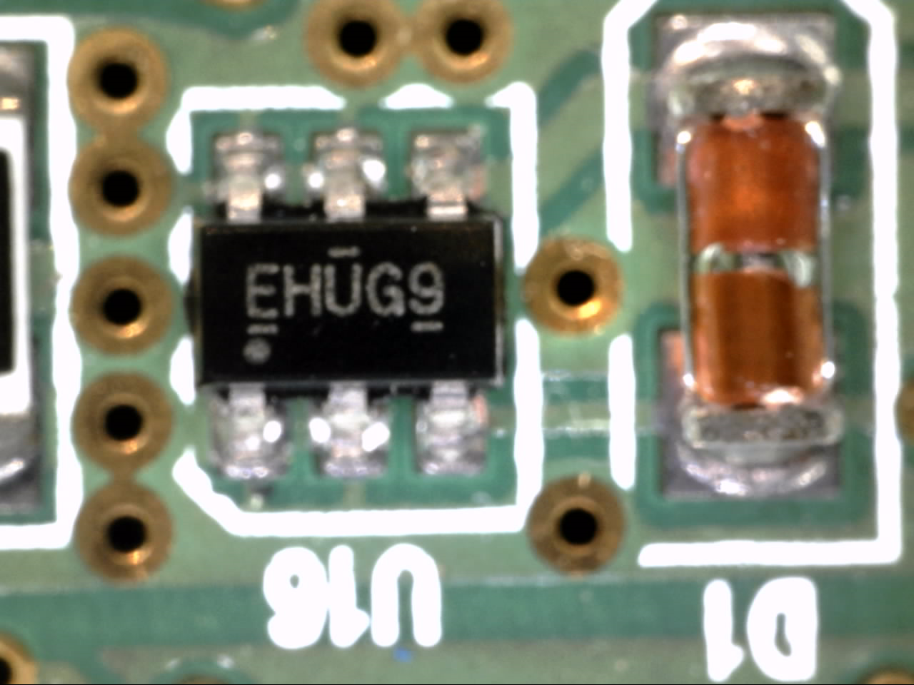

Hi Leonard,
Manufacturer is not willing to share the schematic, however could find out EHUG9 is same as E6fu6 is same at STMs,(STT6n3llh) and I think same as one of TI parts and one more company.
LTA2 was easy it is LTC4412
Now it remains to find out ADLH and AGLW7..

Hi James,
Glad you were able to find some of these devices. Unfortunately, the two remaining devices are not TI devices, and I only have access to TI device markings. In the first picture I saw Vision Battery, looked there for clues as well, but nothing.
