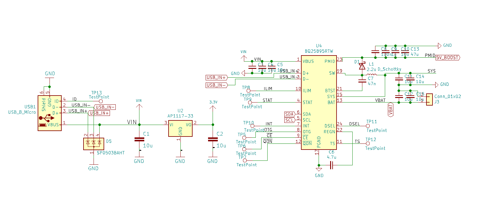

Hi All,
I am working on my first BQ25895 based design and there are some errors and bodges on this board. I have wired CE to GND to enable battery charge however charge does not seem to be starting. The ADC can detect the voltage of the battery so the connection seems good. The schematic is here, with TP6 connected to ground.
