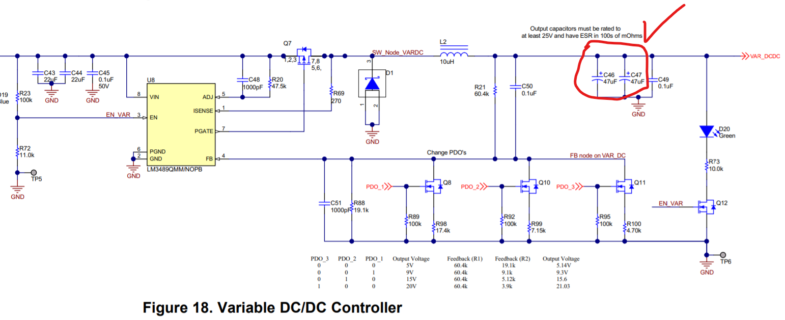

Hi Team,
My customer design portable monitor application and would like to reduce LM3489 output bulk cap value and material because of  dimension constraint.
According to EVM board's design, there are 2pcs 47µF Tantalum capacitors 35V .
So can customer change output cap to 2pcs 22uF ceramic capacitor 25V? The system power rating is below 60W
Or please also advise the suitable bulk cap design?
