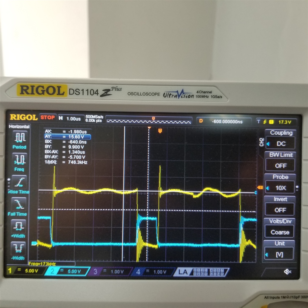

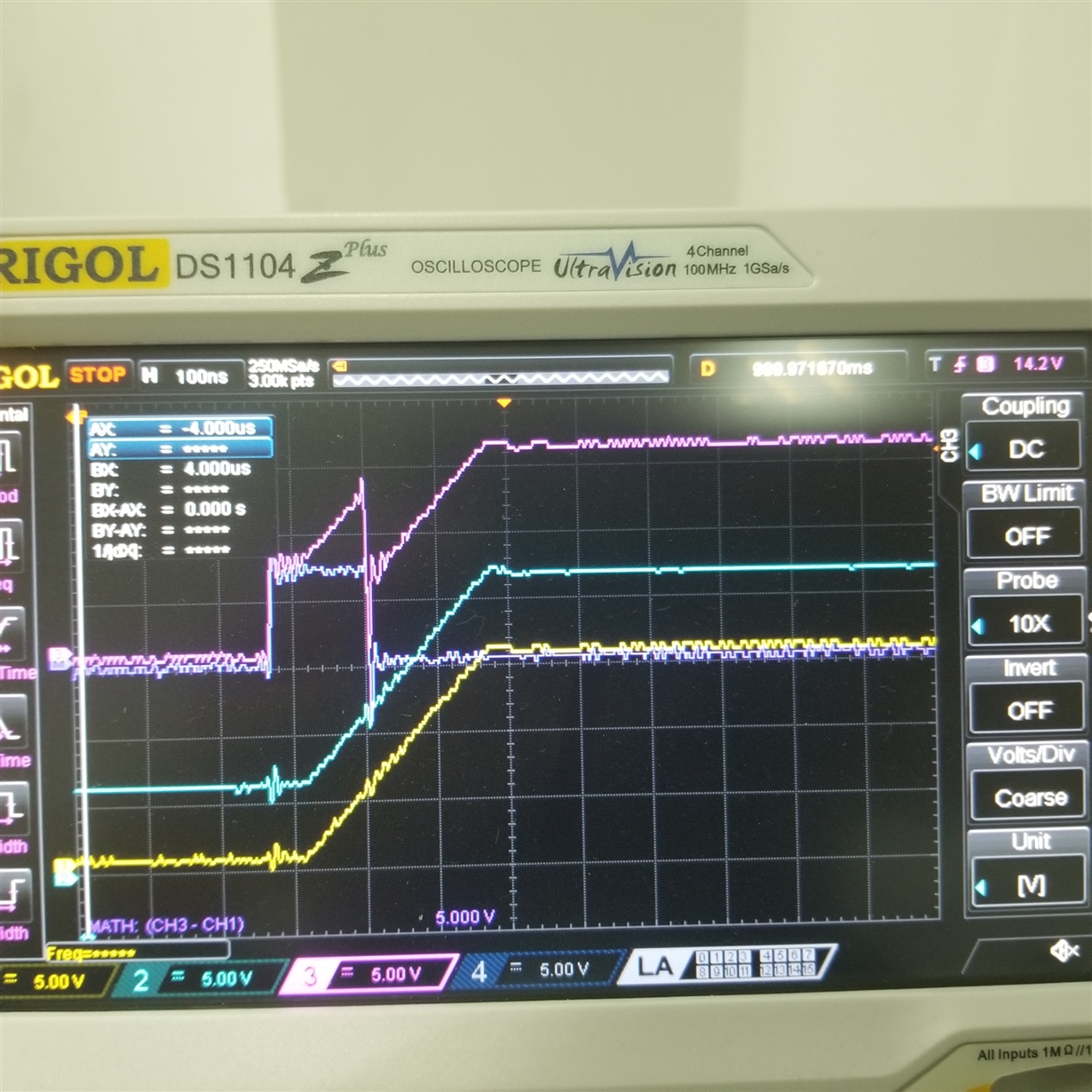

As datasheet shown,the high-side gate drive HDRV2, complementary to the low-side gate drive LDRV2,
controls the high-side synchronous rectifier of the boost stage. I checked my unit, LDRV2 has driver, but HDRV2 no driver signal means no synchronous rectifier. The unit work fine without this issue. I want to know which condition lead this issue. Vin:10V, Vo:15V, Io:4A, Vboot2_SW2: 10V. Below picture CH1 HDRV2(Vgs=HDRV2-Vo at LDRV2 off time), CH2 is LDRV2. And I remove Pin 19 from PCB(HDRV2 have no connect PCB), the waveform is the same.
