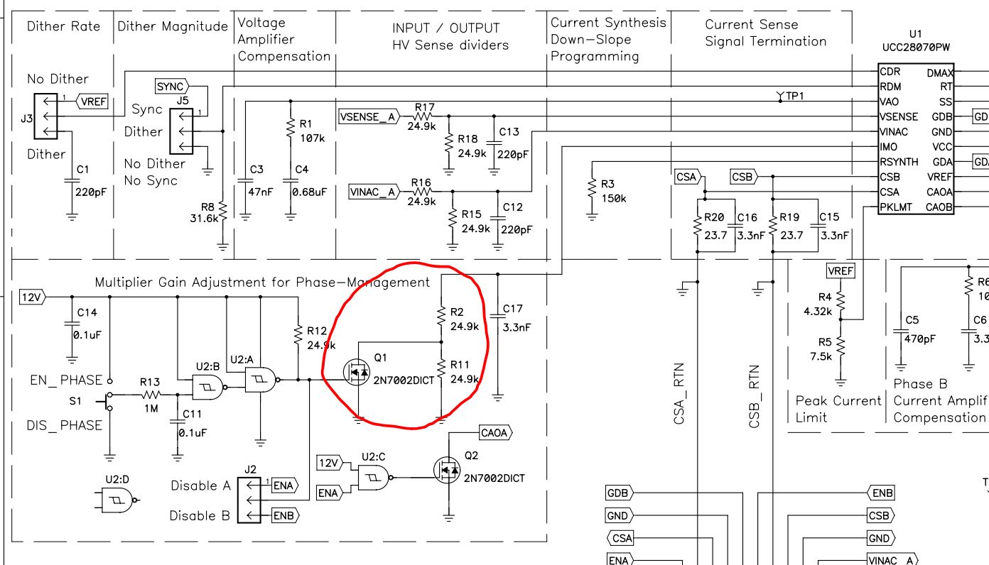

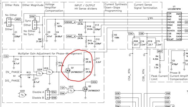

We have a 1.2kW reference design PR780, I could find a document that introduce the design. Do you have a description about the function of the below circuit in detail?
https://www.ti.com/lit/df/slur033/slur033.pdf?ts=1597051579494&ref_url=https%253A%252F%252Fwww.ti.com%252Ftool%252FPR779%253FkeyMatch%253DPR780%2526tisearch%253DSearch-EN-everything
  • Hello Lenna,
    The UCC28070 is an interleaved pfc controller and that means the load power is equally divided between the two phases.
    If you wish to make the UCC28070 into a single phase non-interleaved controller you will need to adjust the IMO resistor value .
    For single phase operation R2 and R11 set the power capability of the pfc.
    For interleaved operation R2 sets the power capability of the pfc.
