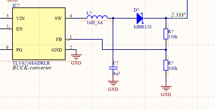

I'm planning to use the TLV62568A  for charging a Supercap.
When the power is off the supercap is still charged so the current can possibly flow back. Is this a problem for the TLV62568A?
I assume the highside mosfet protect the IC and lift the VCC voltage which is isolated with a diode from the rest of the circuit.
 If not, what is the best way to protect the device?
Thanks!

  • Hi Excel,
    Thanks for the reply.
    Do you have a suggested solution for implementing reverse current protection?
    A diode between the L-C and the voltage feedback resistor?
    like this:
    Thanks!
    Edit:: maybe add a C before the Diode in the feedback to add some feedback ripple the peak current controller.
  • Hi Ernst,
    The schematic diagram looks fine but this approach was validated during the device development stage. I recommend to fully characterize the circuit if it fits to your application.
    Just a reminder. Placed the FB resistor divider (330k & 100k) as close as possible to the IC and diode as well. The 100k resistor needs to be connected to the IC Gnd pin to avoid regulation error.
