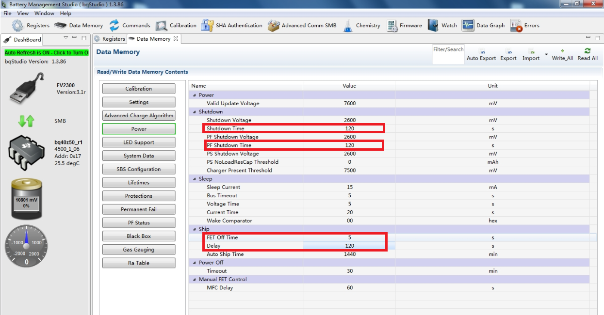

1.Such as the configuration of pictures, is it allowed ?
2.In this configuration (3 cells in series), does bq40z50-r1 work like this? When the cell voltage drops to 2.6v/cell, the IC enters shutdown mode after 120 seconds delay.

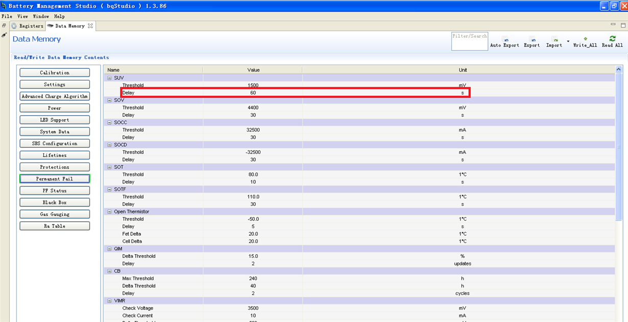

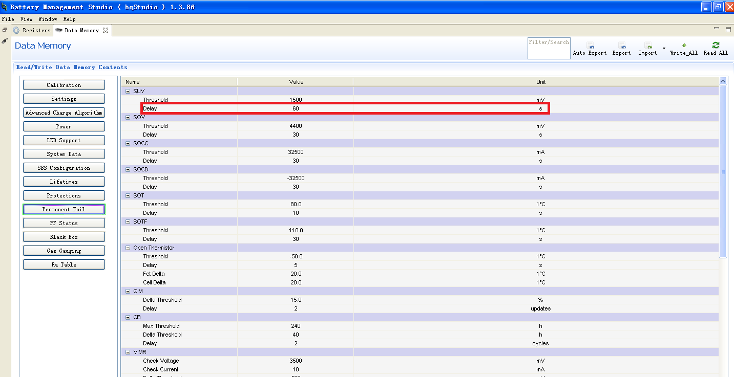

Then the customer is connected to the charger (pulse voltage 2 ~ 12V), and after SUV delay (60 seconds),[note:SUV_ Mode = 1], the battery can enter normal mode? can enter charging, right?
3. Can ship delay be set to 120 seconds? The reason is that the customer's machine has a large capacitance. After the FET is turned off,
the capacitor charges the battery (the time when the capacitor voltage is greater than 2V is about 70 seconds).
