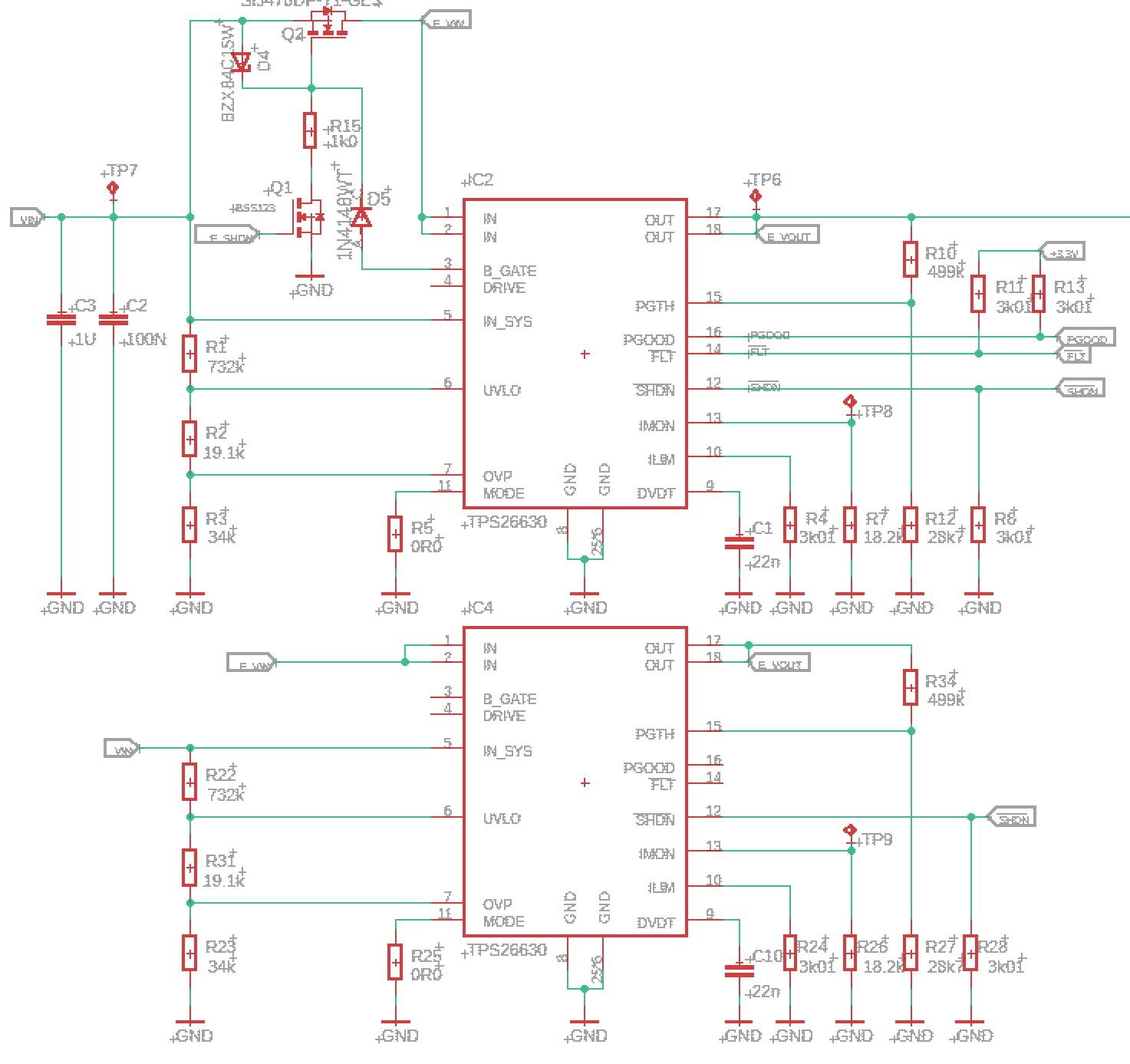

I have two TPS26630 in parallel and this works fine for resistive or small capacitive loads. Bu if i have a bigger capacitive load(5mF for example) the startup behavior to me is a bit weird.
The schematic is attached below.

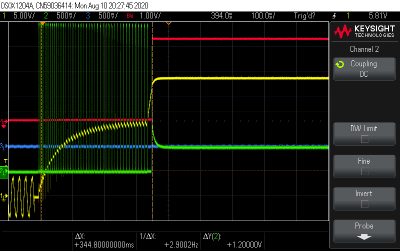

In the Oscilloscope picture the startup behavior is visible.
Ch1, Yellow, is Vout
Ch2, green, is Imon of one of the 2 tps26630
Ch3, blue , not attached
Ch4, Red, Pgood signal
It's great that it starts up, but i'm not sure the startup is ok...
Can you advice me in this?

    It is the expected behavior. Due to large capacitive load, the device goes into current limit mode of operation and then gets into thermal shutdown. Can you increase capacitor at DVDT pins to 1.5uF to set lower inrush current so that the power stress across the device will be low to avoid thermal shutdown.
    Another approach is to force the device into thermal regulation loop with Cdvdt = OPEN similar to Figure 22 in the datasheet.

    Yes, i managed to test and it works great. We need to investigate a bit more to find our ideal settings. Those big capacitive loads are not standard and we don't want a startup time which is that long.
    But, your answer did help us a lot to get to the cause of the issue, so thank you!
