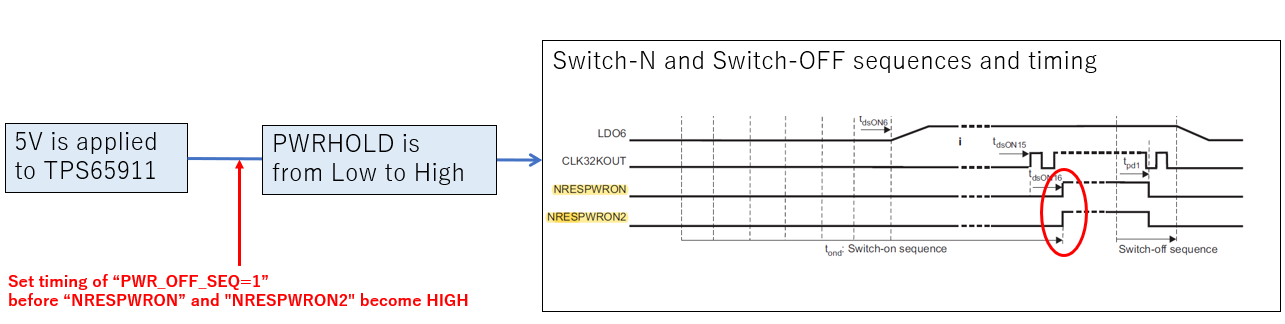

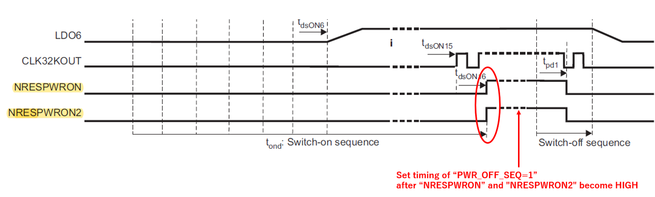

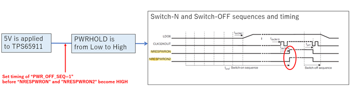

Hi Team,
We would like to know the set timing of “PWR_OFF_SEQ=1”.
We guess that the timing is after “NRESPWRON” and "NRESPWRON2" become HIGH.
Is my understanding correct?
If no, could you please let us know the suitable timing?
