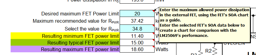

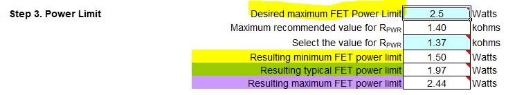

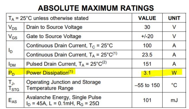

Could you please comment on how to determine the desired max. FET power limit if engineers choose CSD17553Q5A? 3.1W?
Considering the current accuracy, is there a lowest limit?
