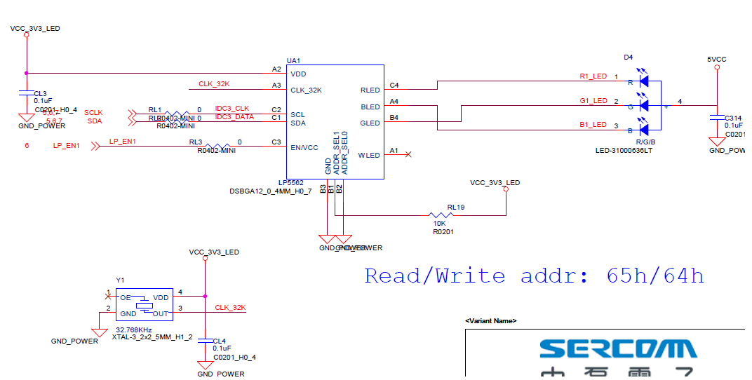

We use LED driver(LP5562) on our boards, but led don't light up.
We measure voltage and check EN PIN, they are all normal.
We control it through i2c tools on linux.
The following is some information:

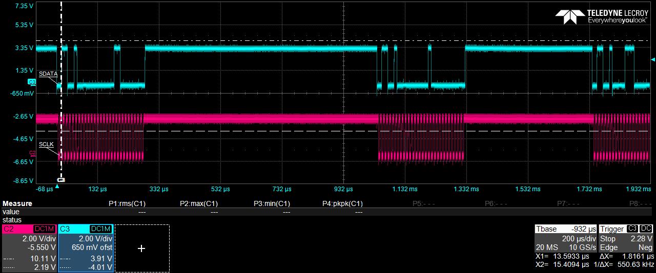

I2C Waveform:
Device Connection:
Please help us check issue.
