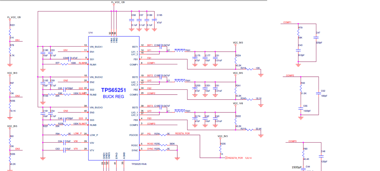

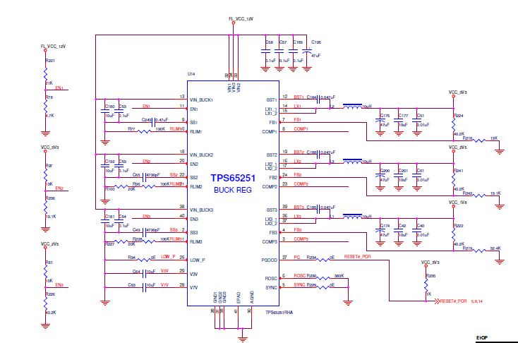

TPS65251: PFM mode error.
Part Number: TPS65251
My input voltage is 12V, O/p of buck1 = 3.3V, Buck2 = 2.5V, Buck3 = 1.8V.
1. During the bringup, the EN of Buck1 is toggling i have checked the input ripple which is around 500mV.
2. When i am checking the datasheet there where two modes PFM and PWM. During the light load condition it will be PFM mode.
3. There is an graph which says that Transition from PFM to PWM mode.
4. LOW_P pin is pulled down to ground.
5. Load is connected.
Issues :
1. Buck1 o/p voltage is coming around 1.8V but it should be 3.3V.(Cross verified the resistance)
2. Buck2 and Buck3 is turned off.
We want to Know why it is in PFM mode and How to change to PWM mode. Is there anything to do with the LOW_P pin?
