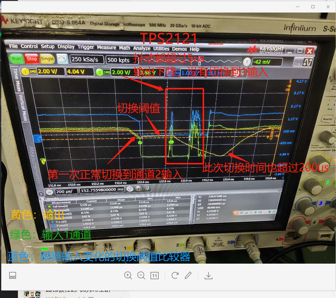

TPS2121 output is normal,when the input 1 is Pull out. The pull out cause shake,the waveform is below. when there is shake,the output is Pull down,do not switchove with the shake.
