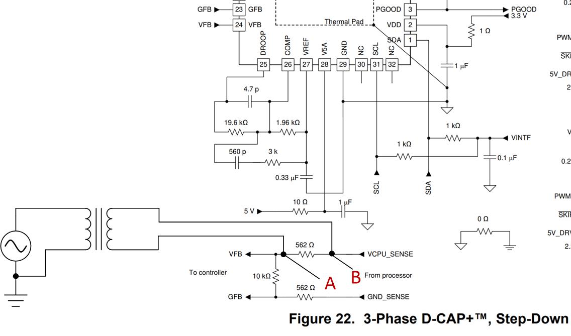

Hi Team,
Can you advice correct technique for TPS59632-Q1 stability measurements/loop response in 2-phase and 3-phase applications?
  • Hi Piotr, it is similar to 1-phase converters. I made a sketch below. You may get more consistent results if you have a connection to a sense point local to the powerstages, but the connection is the same.
    You can contact me/Rama V offline if more advice is needed.
