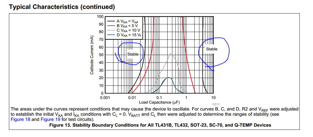

There is below figure in datasheet which recommend stable area. So just want to check
1. which area is your recommendation? Is there any difference working in these two areas, such as vref accuracy / noise?
2. Is it OK to use CL=1uf or CL=0.
