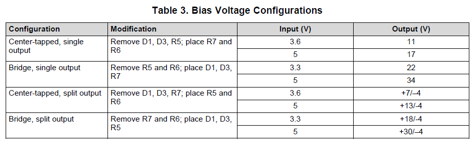

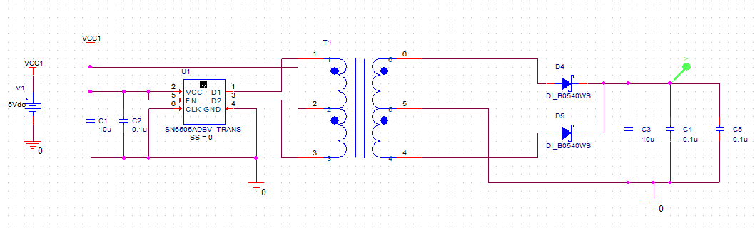

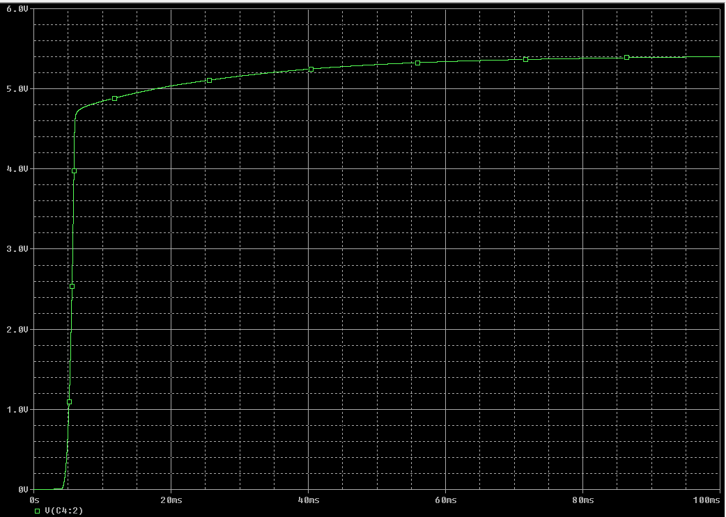

I am trying to simulate the SN6505B Bias Supply using center-tapped, single output configuration. When applying 5V input I am expecting an 17V output, but I am only getting an 5V ouput.
Can you help me in understanding why I'm not getting the correct output?
I'm not sure how to change the winding's on the transformer (if that's the issue) because the PSpice script is encrypted.
See below for schematic, sims and configurations. Here's the EVM user guide: 8078.TI ucc5390-q1 Gate Driver User Guide.pdf
