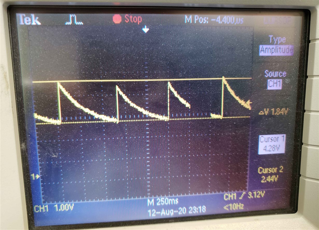

We use the LM5576 in one of our security products and are having intermittent startup issues.  When input voltage is applied (12v~48v), the output voltage which is supposed to be +5V is cycling at a rate of 1.587Hz looking like a ramp with slow decay.  The +5V is feeding the bq25606RGER LiPo battery charger so the current is limited well below the 3A max of the LM5576.  This problem is intermittent so it looks like a start-up issue.  I have attached both the schematic as well as the oscope output.  Any direction would be helpful and appreciated.

  • Thank you for the input, changed the soft-start cap and still no change.  The bQ has been removed from the equation for this part of the troubleshooting. At the output from the inductor of the LM5576 we get a solid +5V, so for our next test we placed a 5 ohm load resistor to ground, producing a 1A load at +5V.  The LM5576 immediately went into the error condition with the voltage ramp as posted earlier.  When the load was removed the error condition persisted requiring power to be removed from the LM5576 part to clear the issue.

  • An additional note.  We added an external capacitive load of 220uF on the +5V and simply the process of powering up the system caused it to fault, so it is definitely an issue with some sort of inrush current causing the part to fail proper operation, and the error condition not clearing itself when the issue is cleared.
    Allan
  • The problem has been identified and fixed.  It seems that manufacturing loaded the incorrect resistor for Rt (50 ohms instead of 21K) and for some odd reason the chip did not like or appreciate that.  Thank you for your input and direction, the problem is no more.
