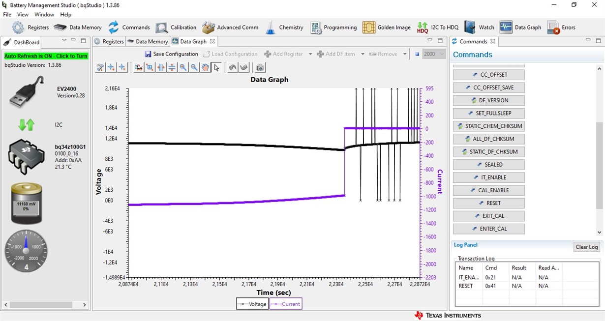

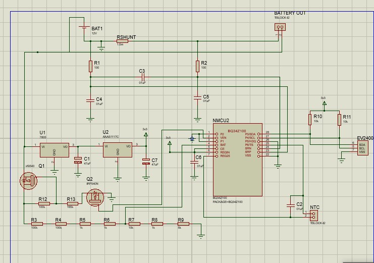

perform the configuration as indicated in the log files as I am working with a 12 volt 7 amp hour battery from yuasa the corresponding indicator is 808 for its chemical identification add the mosfets according to the specifications for multicells as indicated in the reference sheet .
questions in question

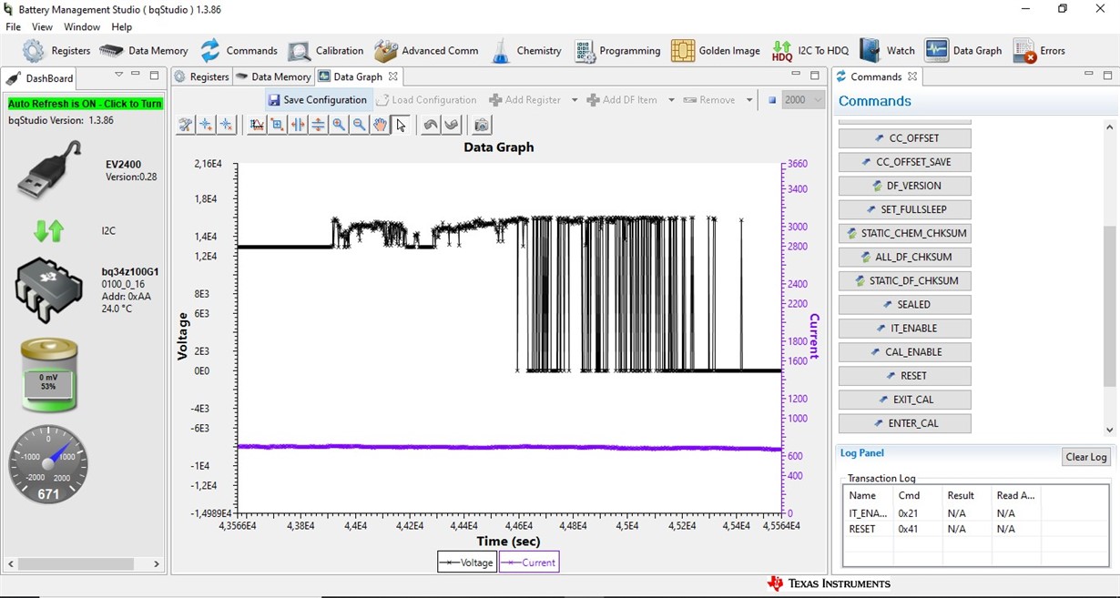

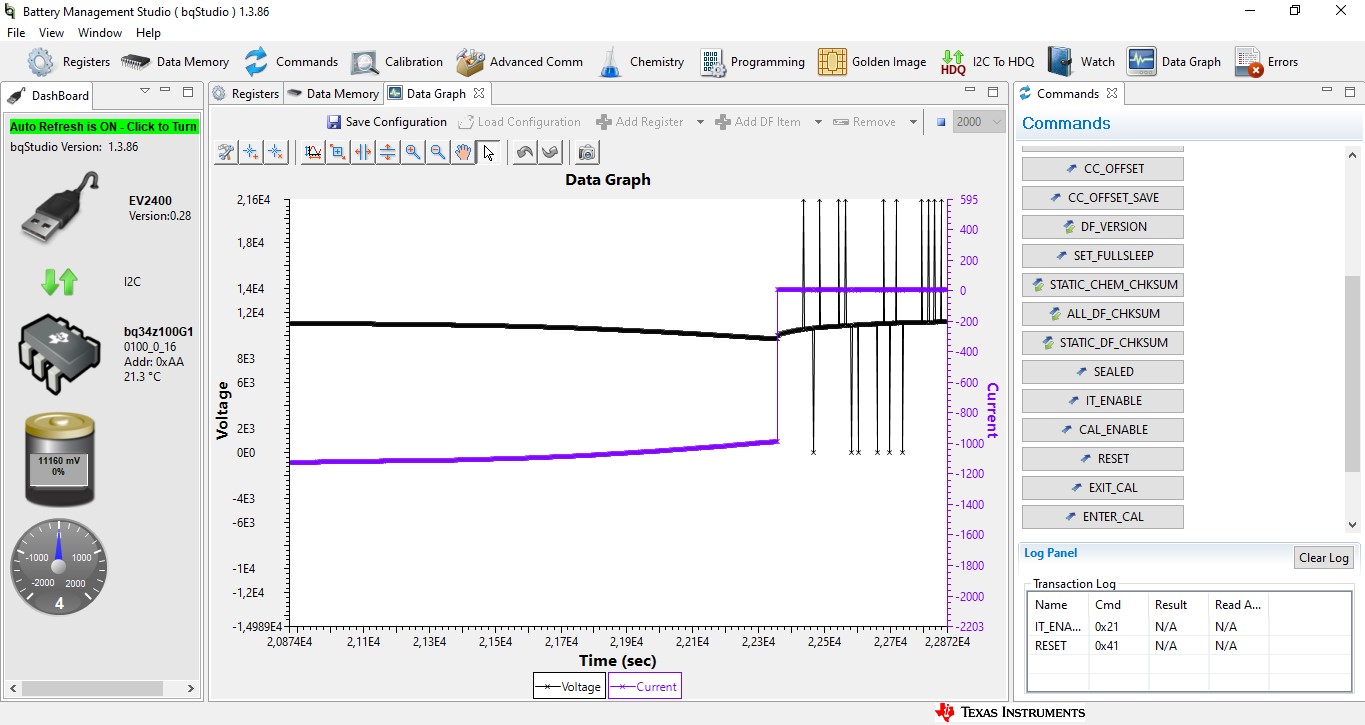

In the learning process, after 4 hours of charging, voltage peaks are presented as they appear in the reference images
followed by the sequence of voltage peaks, a load value of 53% is indicated and 0 volts the current does not present oscillations in its measurement
the update status record remained at 00  pba127a12082020.gg.csv
