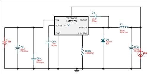

Hi Team,
This is customer request and i would be very happy if you can support:
My customer currently working on EE: CNC control  and they need support on DC/DC power supply.
The question is they used Webench for this design decided to go with LM2679:
But here when they followed 8.2.1.2 Detailed Design Procedure from datasheet and they got different resulted inductor values as: 25uH.
Technical parameters are Vinnom:24V, Vout:5V, Iout:5V. Can you please confirm if we should use the calculated values by datasheet or webench?
Another question is on datasheet Table.3 L41 inductor is 22uH with part number PE-54041 but datasheet claims that it is 25uH?
