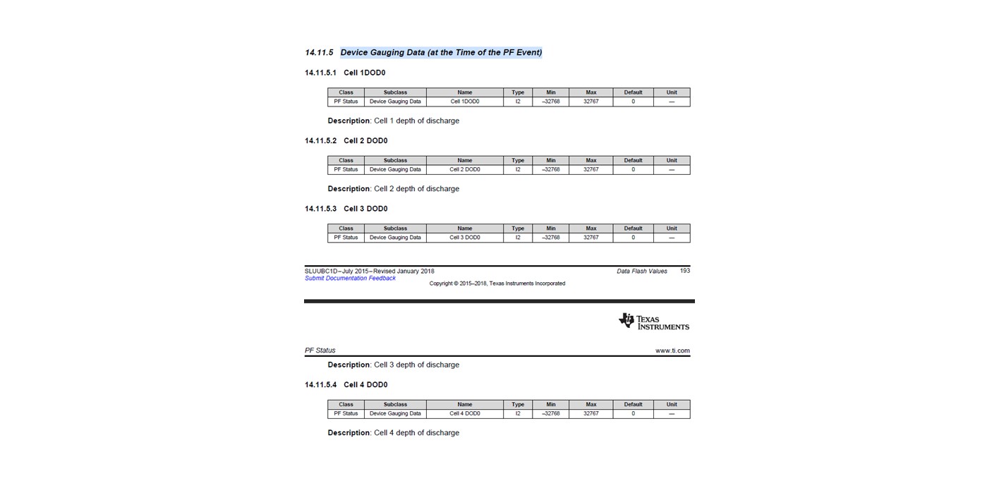

Hello Sir:
We need more explain about the function of Device Gauging Data (at the Time of the PF Event).
What the main function of Cell 1 DOD0 ~Cell 4 DOD0 is?
Please kindly provide more explain and application for me.
Thank you very much.
Hello Sir:
The DOD data is the opposite of the SOC and it uses a 14 bit number (0 to 16384), DOD is used by the gauge for it's capacity calculations. You can refer to the app note on the Impedance Track algorithm for more information: https://www.ti.com/lit/an/slua450/slua450.pdf
This data is just stored when the PF event occurs so the DOD for each cell can be known at the time of a permanent failure.
