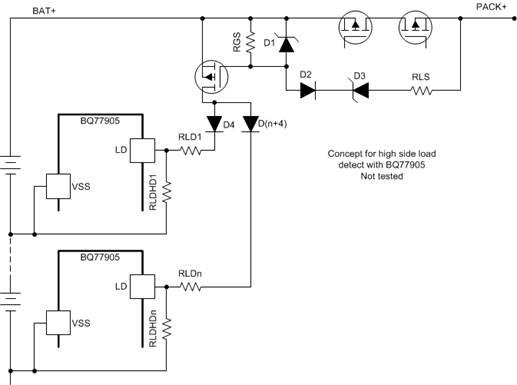

Does anyone have experience converting the BQ77915 to high-side-base control, using NFETs (or PFETs)? I am finalizing a design and wanted additional input. My design will leave the shunt resistor at the pack negative, but switch the pack positive via Toshiba TCK401G charge pump gate drivers off the CHG/DIS pins. This is because I need to turn the pack outputs off/on often, but leave the GND referenced properly (for multiple obvious and not-so-obvious reasons). I'm using NFETs because the continuous current for this BMS design is 165A (24 FETs in total).
I'm also curious to know if the SRN/SRP ratings are referenced to each other, or VSS? It would vastly simplify my design to use high-side current monitoring, as well, without the complication of level-shifting the output to mimic low-side sensing. For now, I will leave it as low-side sensing.
