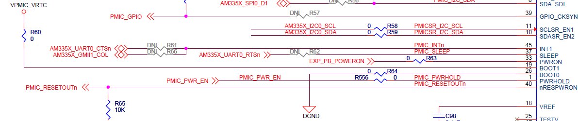

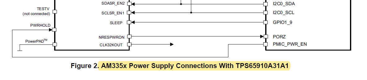

My customer is using TPS65910A31 to power AM3358.
In AM3358 EVM schematic as below, it configures BOOT1=1 and BOOT0=0

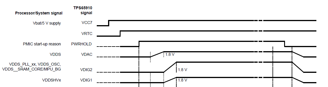

But in TPS65910A31 datasheet, it only gives the power up sequence of 'BOOT1=0, BOOT0=0' and 'BOOT1=0, BOOT0=1' on Figure 5-1 and Figure 5-2 . So could you please help on:
1. Can you confirm whether we should use BOOT1=1, BOOT0=0 for AM3358?
2. Can you provide the power up sequence of BOOT1=1, BOOT0=0?
