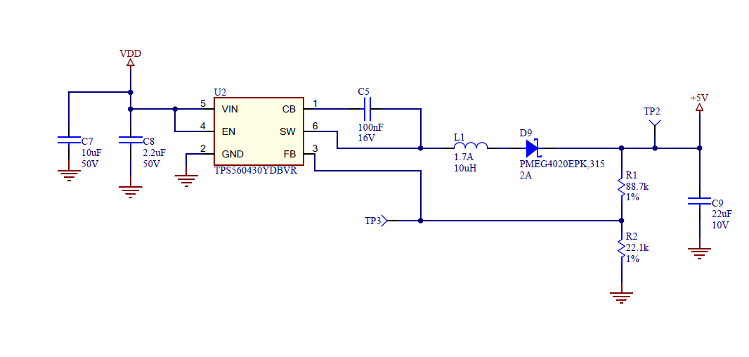

TPS560430: TPS560340 FB pin at 1V on unpowered TPS560340
Part Number: TPS560430
If I want to alternatively drive the Output Voltage with a different 5V supply, Is it okay to put a Blocking Diode in series with the Inductor and have 1V on the FB pin of an unpowered TPS560430?
  • Hello
    It is best to put the diode at the output and block voltage to the regulator.
    TI has OR'ing type devices that can be used for this function.
  • To clarify:
    Will This work if VDD=0V and +5V=5V?
    Is backdriving FB with 1.0V okay?
  • Hello
    No, the diode can not be placed between the inductor and output cap.
    It must be placed in the DC 5V line to the load.
    Usually it is not a good idea to allow voltage on the output of a regulator when the input is zero volts (or even floating in some cases). This condition could be caused by a very large output capacitor that is charged when the input is removed, or some kind of active load suppling a voltage. There is a diode between the drain(VIN) and source(SW) of the power MOSFET inside the converter. With a voltage on Vout, and the input held at zero volts, there will be a path from Vout to Vin through the inductor and this diode. Even if the input is floating, a current will flow and try to charge the input caps, possibly to a high voltage due to resonance with the caps and the inductor.  This phenomenon has been seen in the past under some conditions. Allowing current to flow through this diode can cause a parasitic to turn on or even damage the diode.  Since it is not a "true" diode but a parasitic formed when the MOSFET is constructed on the die, it is not designed to take current for more than a few 10s-100s nsec. One way to avoid this issue is to use a diode from input to output to provide a path for the output capacitors to discharge around the device.  A Schottky diode with cathode connected to Vin and anode connected to Vout can be used. A blocking diode in series with the load can also be used. Or one of the TI OR'ing controllers can be used.  Please also see app note SLYT689 for more information.
