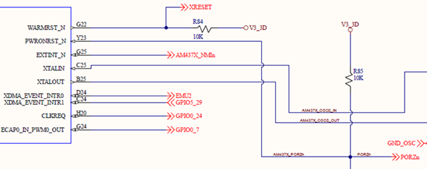

I have a customer are using the TPS65218D0RSLT PMIC to support the AM4378BZDN80 Sitara.
They are seeing an issue we do not understand and are requesting your input and guidance per below description.
The PMIC receives a reset (pulled to ground by a switch…same as implemented in the AM437X GP EVM) through the WARMRST_N (called XRESET in our schematic below);
However, the PMIC DCDC outputs (other than DCDC5 and DCDC6) shut off and do not recover after the reset action until input power is cycled OFF/ON.
Do you have any thoughts/suggestions for us to continue our investigations?

  • We have also found that if the PMIC Strict mode is Disabled (bit set to 0), there is no issue with reset and recovery (PMIC rails power up normally).  We are thinking that this might point to an issue with OV during power up, but we do not see any issues when probing with a scope.  Thank you for your feedback and help with this.

    We are using the AM437.  During the reset (Warm Reset), DCDC5 and DCDC6 do not shut down...they stay high/ON (only DCDC1-4 shut down).  Regarding the FSEAL, once the Warm Reset is activitated, the PWR_EN also stays high.
    Upon reviewing the 437 TRM, it appears using Warm Reset is valid.
    FYI, we also have a PHY device (Microchip KSZ9131RNXI).  If we plug in the LAN cable to the RJ45, the same shut down issue occurs and does not re-start without a power cycle.

    Attached is the AM4378 GP EVM we are using as guidance (uses the TPS65218 vs. the TPS65218D0 part we use) and WARM RESET function (Sheet 2...tied to the AM437 G22 port).AM437X_GP_EVM_3K0006_SCHEMATIC_REV1_5B.pdf

    We are not using the GPIO3 as the WARM RESET...it is tied to G22 (WARMRST_N).  The PWR_EN pin does not go low (it is also tied to RTC_PMIC_EN which is AD6).

  • Barry & Will,
    Please confirm that the WRMRST_N (or XRESET) signal is connected to GPIO3 of the TPS65218D0 PMIC.
    It is not relevant how this signal is connected to AM437x processor if the PMIC is experiencing the issue.
    The WARM RESET feature of the PMIC is pretty straightforward: DCDC1 and DCDC2, which support DVS, are reset to the default value of 1.1V output voltage.
    The issue you are seeing is related to the narrow window of masking VOV and VPG faults during the DVS transition. See, the AM437x processor reduces its CPU load during the reset and the PMIC is likely trying to go from a higher voltage (1.35V, for example) to 1.1V with a large amount of output capacitance.
    Therefore, it is reasonable that changing the STRICT bit from 1b to 0b will resolve the issue because STRICT=0b disabled all the VOV (over-voltage) faults. Your problem can be fixed in one of 2 ways:
      1. Reduce the output capacitance on DCDC1/2 until the issue no longer occurs
      2. Permanently set STRICT=0b (either by adding it to the initialization routine of AM437x processor, or by re-programming the EEPROM memory of the PMIC)
      • Instructions for re-programming the EEPROM memory of the PMIC are provided in the TPS65218D0 datasheet
      • AM437x does not require STRICT=1b. This ultra-sensitive voltage monitoring is only required for AM438x (secure applications such as ePOS)

    We may continue with the STRICT=0b as this has resolved the issue (our only concern was OV protection of the AM437x).
  • Brian,
    Quick question; on the TI EVM (schematic attached) the  WRMRST_N is not connected to the PMIC GPIO3.  Should this be used rather than the 437x RESETIN_OUTn (as the TI EVM)...or both?4024.AM437X_GP_EVM_3K0006_SCHEMATIC_REV1_5B.pdf
  • Please refer to Figure 1 and Figure 7 in the Powering the AM335x, AM437x, and AM438x with TPS65218D0 User's Guide, which shows GPIO3 pin of the PMIC connected to a WARMRSTn pin of the processor.
    It is my understanding that this pin on the processor is the same as RESETIN_OUTn (pin G22) on the EVM schematic you shared, which should also be connected to the GPIO3 pin of the PMIC. The signal connects to every other IC on the schematic (Ethernet PHY, Touch-Screen Controller) that needs to be reset except the PMIC, but I cannot say why it was done this way.
