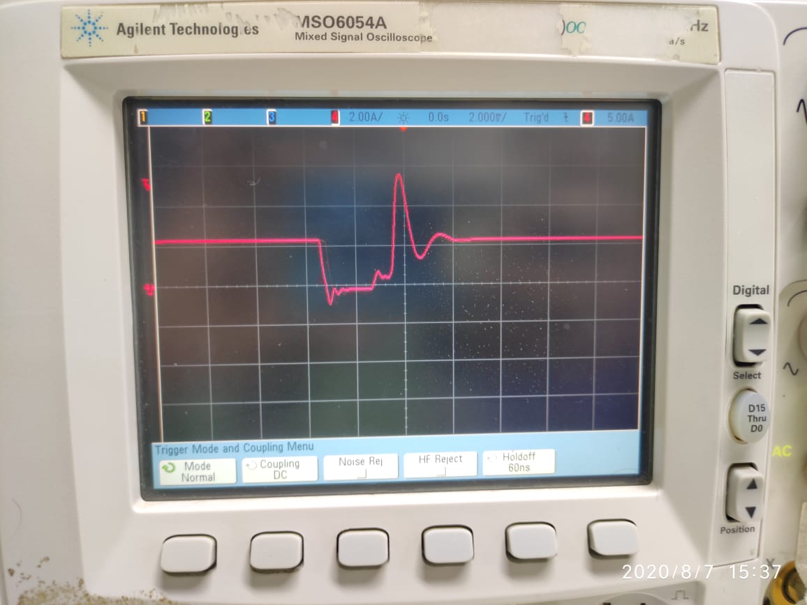

We are using LM5121 - Synchronous buck converter in one of our application. The converter was designed to generate an output of 10V/6A from an input of 4 - 5V.
The load connected to the converter was a switching load, While testing we have noticed an Output voltage dip of about 1V.
The voltage dip is whether due to any Control loop instability.
Details On converter design are given below.
Input Voltage : 4 - 5V (Capable to source Maximum of 60A)
Output voltage : 10V / 6A
Switching Frequency : 450KHz.
Rcomp : 8.25K Ohm.
Ccomp : 0.018u Farad.
CHF : 470p Farad.
Please help us to resolve this issue.
