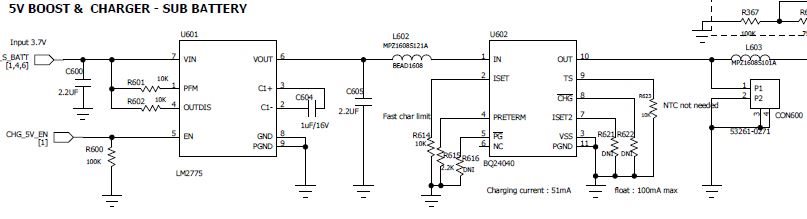

Hi.
As shown in the circuit below, the input power of the charger IC (bq24040) is designed as LM2775.
For 3.7V input / Iout =50mA output, I expect the input current to be around 50mA, but  it measures 116mA.
Even if PFM_OUTIS = 0 or 1, the same result .
Please review if the circuit is wrong
Thank you.
Mark.

    Thank you for posting.  Do you have question about LM2775, or about BQ24040?  By the way, the picture link is broken.
    Regarding LM2775, if Iout=50mA, you should expect to see >50mA input current because  Iin x Vin x efficiency = Vout x Iout.  Otherwise, your efficiency will be > 100% and it is against fundamental physics.
    Assume 60% efficiency (referring to Figure s11 and 12 of the datasheet), then your input current would be (5V x 50mA ) /(3.7V x 60%)=113mA, close to what you measured.

  • Hi Youhao Xi,
    Thanks for your reply.
    I missed the basics including dc/dc efficiency.
    Attach the photo again.
    Please point out if there is anything wrong.
    Thank you.
