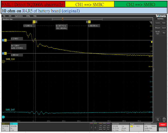

BQ42060A board is as below: R4, R5, (for SMBC) ,  R6, R14 (for SMBD) is NOT the same as recommended in BQ2060A datasheet.
( Note : my customer's BQ2060A  board designed for mass production over 15 years.)
1. We encountered sometimes can not detect BQ2060A board when customer current designed as above circuit
   meanwhile we have measured waveform of SMBus just found SMBC falling occurs bigger ringing as below :

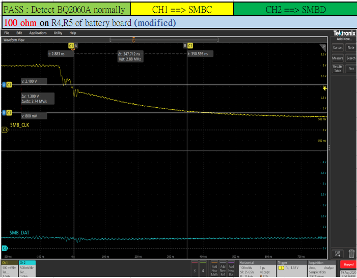

2. We have modified R4, R5, (for SMBC)  from 10 ohm change to 100 ohm like as BQ2060A datasheet then test over 100000 times still can detect BQ2060A  normally
    meanwhile we have measured waveform of SMBus just found SMBC falling occurs smaller ringing as below :
Due to we have all check SMbus waveform for High , Low , Setup , Hold time all can meet BQ2060A spec.
So we wonder to know how to calculate the right resistor value in the circuit ?
Why BQ2060A 's SMBC used 10 ohm will happened stronger reflection NOISE ?

    The EVM users guide shows an example of the circuit using 100ohm resistors in series with the line: https://www.ti.com/lit/ug/sluu179/sluu179.pdf?ts=1597855109354&ref_url=https%253A%252F%252Fwww.ti.com%252Fproduct%252FBQ2060A

    So this error is occurring on a board and chip that hasn't changed for 15 years, now with a new lot of the bq2060a they are running into this communication problem? If so we will have to check if the hardware or firmware has been modified at all.
    I don't believe TI has documentation on selecting a dampening resistor, usually using 100ohm is the standard.
    The design must've been updated from the old EVM to the 100ohm value, it's possible because of an issue like this.

       Thanks for your prompt reply on this issue, we will inform cutomer to using 100 ohm on damping resistor from TI suggestion.
