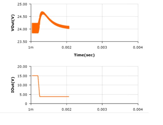

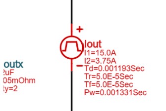

  • So that makes sense to some extent. but I am then confused by the webench operation. like I said I put in the parameters below
    where my understanding was the output was a 15A peak but I am not sure if that is correct. and then I look at the generated schematic which shows 2 different Iout, where I assume I1 is the peak current and I2 is the load current (is that correct?)
    How do I set the Webench based on the load current and not the peak current?

  • Ah sorry about that yes. let me reupload.
  • Hi Brittany,
    Thanks for the information.
    Let me explain it. The output current is already filtered by the LC and is treated as a constant current. Hence, there is no peak/valley for this current. But if you are thinking about peak current as maximum current, then you are right. The place you input the parameters are for the maximum load current.
    Regarding the I1 and I2 shown in the schematic, it gives you the load transient, which means the load current pulses between I1 and I2 (which is why it has the pulse symbol on the Iout sink). This is more related to the loop response than the power stage design.

  • So what is the output current from the parameters I set in the previous message? the simulation shows the current going from the spike of 15A to what appears to be a steady-state current of 3.75A . So I am still confused then on what the steady-state current that this design can output, and how to change it if you are saying the 3.75A is part of the pulse.
  • Hi Brittany,
    Could you share with me the link for your Webench?
    The 15A is the maximum output current per definition. You can try set I2 to be 15A as well. That might give you the steady state at 15A output.

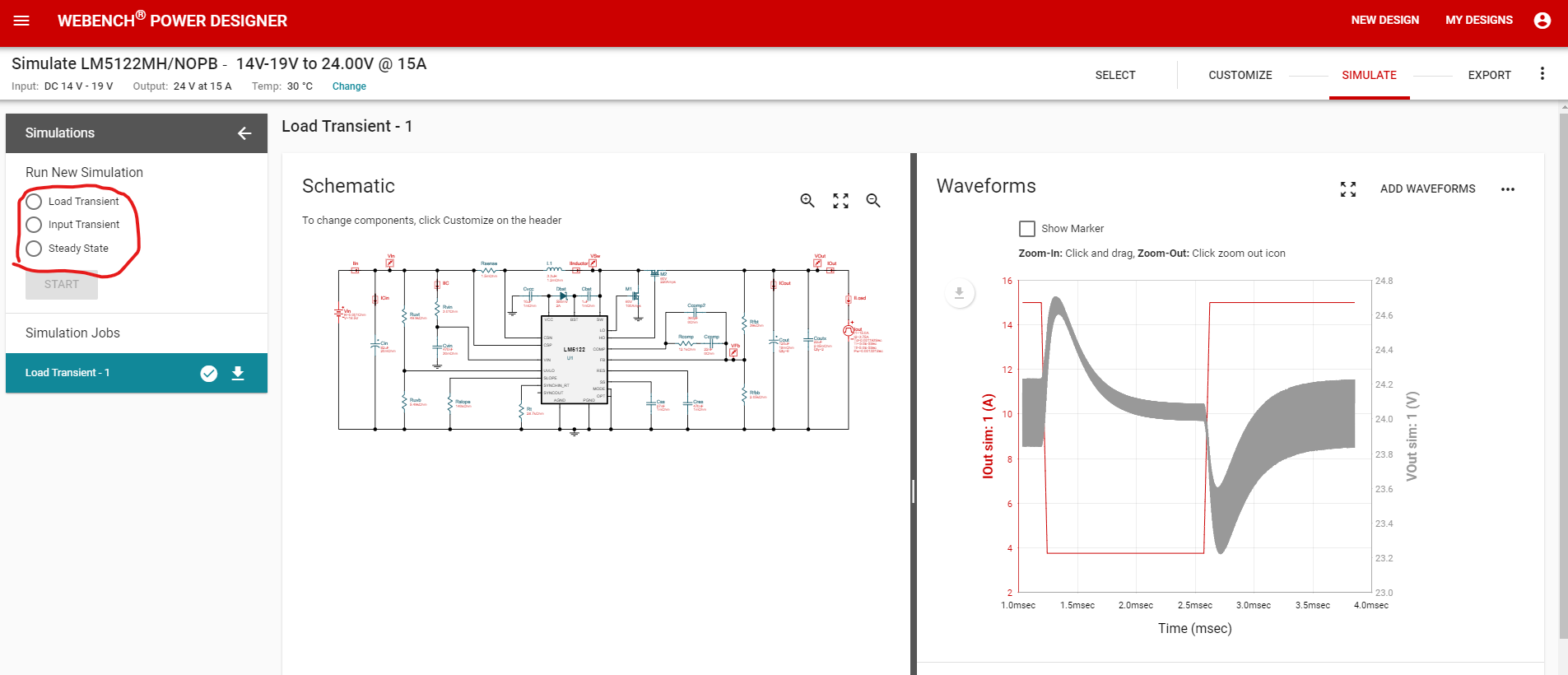

  • Hi Brittany,
    Please see the screenshot I got.
    Please check the "steady state" instead of "load transient" in the selection list on the left hand side circled in red. And then click start below to run again.
