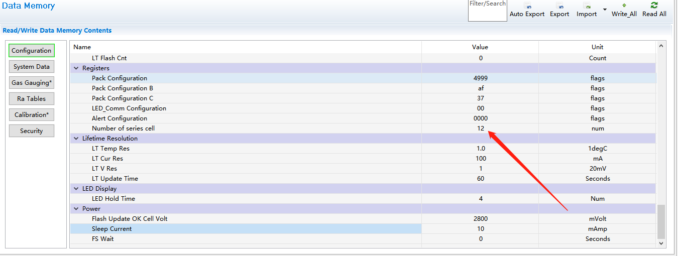

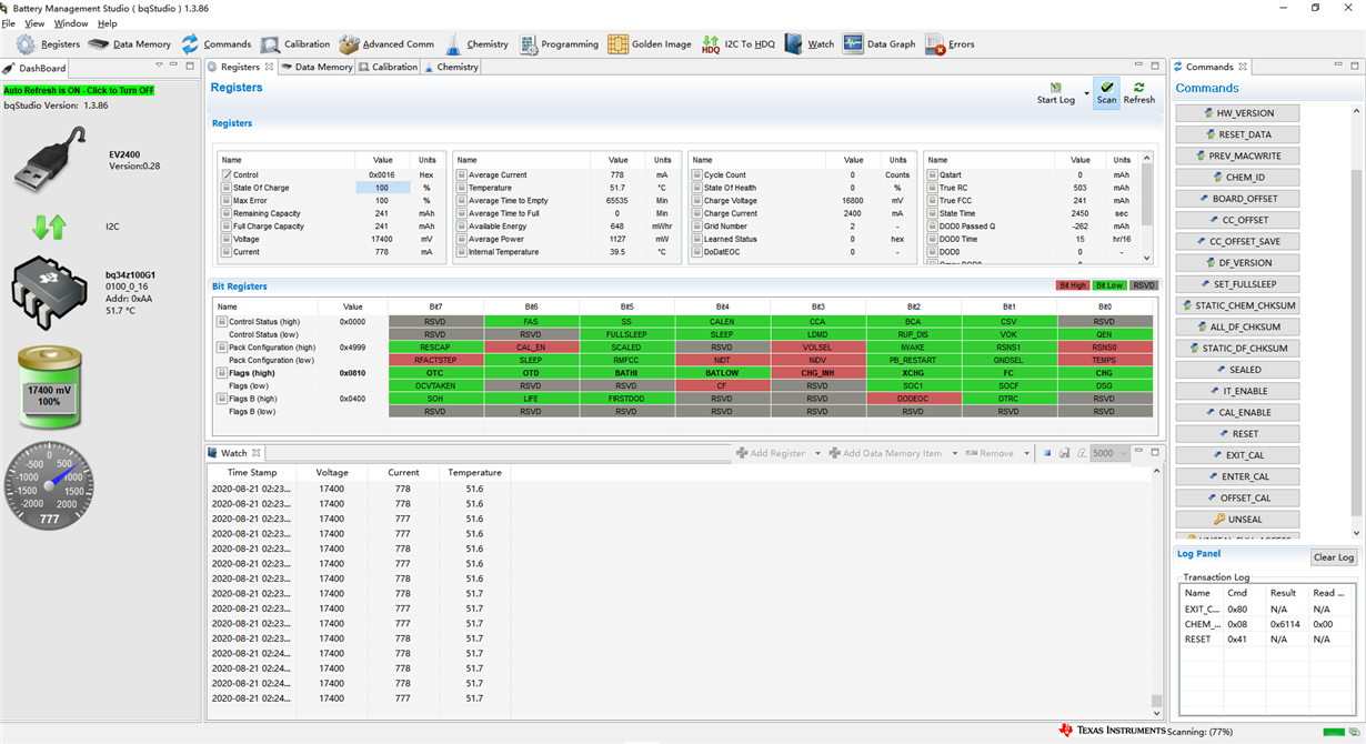

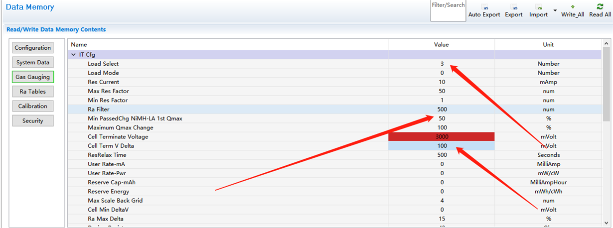

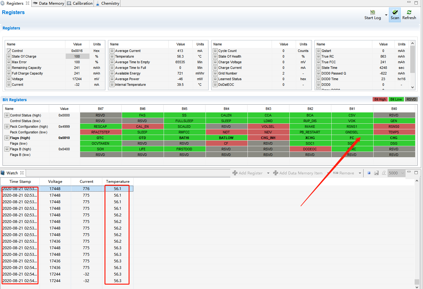

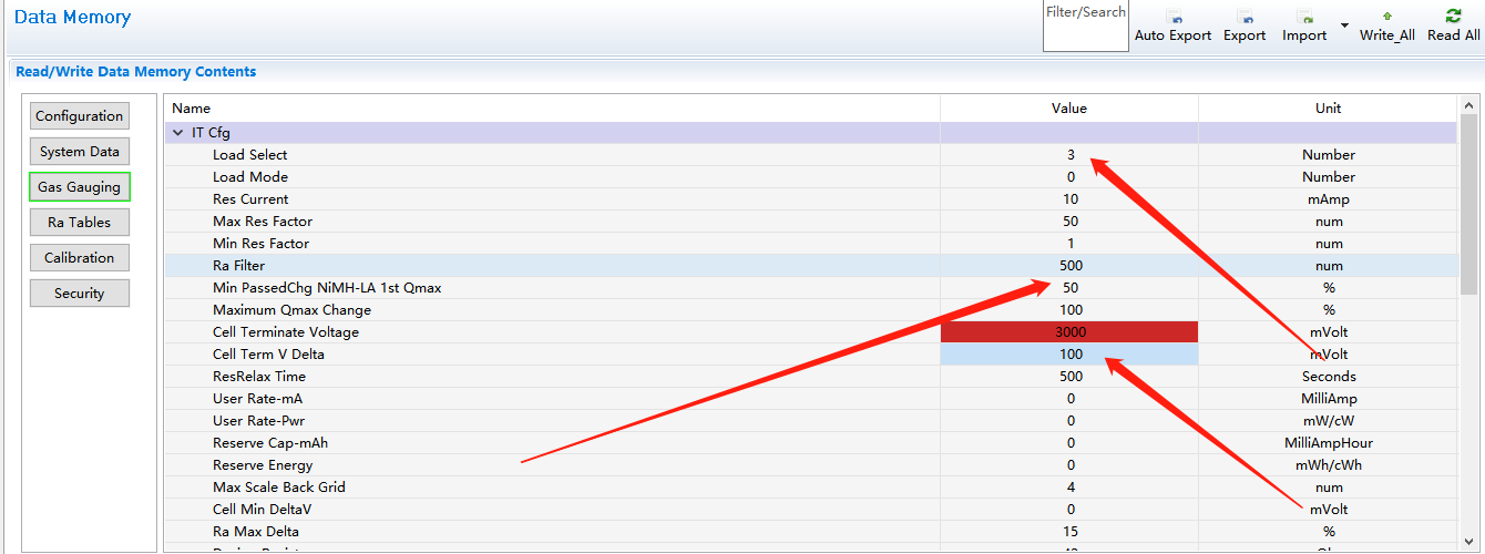

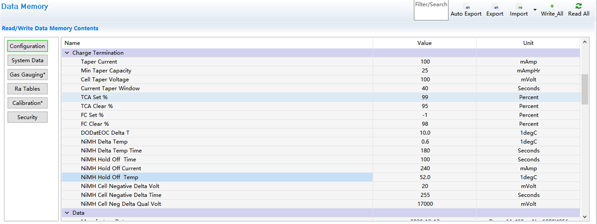

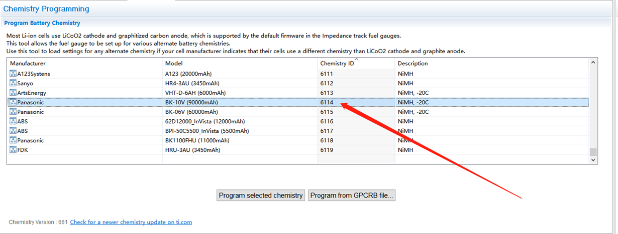

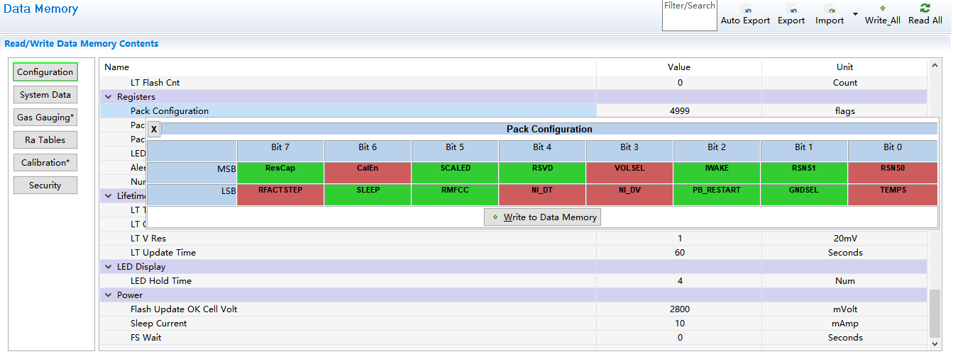

I use bqstudio to get the golden image about my bettery .Battery is 12sNiMH(8000mAH),No matter whatever i config the flash .The FC is not set.
How have you selected the chem ID for your BQ34Z100 and battery? You will need to select the right chemistry ID for your battery before getting FC to set correctly.
Follow the guide in this thread: https://e2e.ti.com/support/power-management/f/196/t/825535
