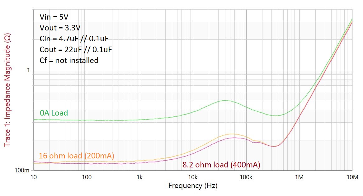

My customer requires frequency response (100Hz to 10MHz) with attached circuit and condition.
Can you provide measurement results or simulation results of frequency response?

Hi Nobuo,
I should be heading into the office within the next 1-2 days and can take a measurement of the output impedance if we have an EVM available in our lab.
If an EVM is not available, it will take 5 business days to obtain one due to standard shipping times.
The output impedance gives an indication of transient response across frequency.

Hi Nobuo,
Unfortunately we do not have these readily available in our lab.
I have placed some EVM's and samples on order, but shipping will require 5 days before it arrives.
I should have a measurement for you in the second half of next week.
- Stephen

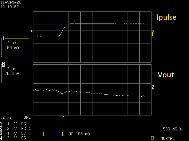

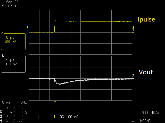

Hi Stephen,
Thanks a lot for your support on frequency measurement.
Customer requires additional measurement as attached.
Could you also support it?
Hi Nobuo,
Yes I should be able to support this.
I was in the office today and the EVM has not arrived.
I will reply back when I have additional data.
