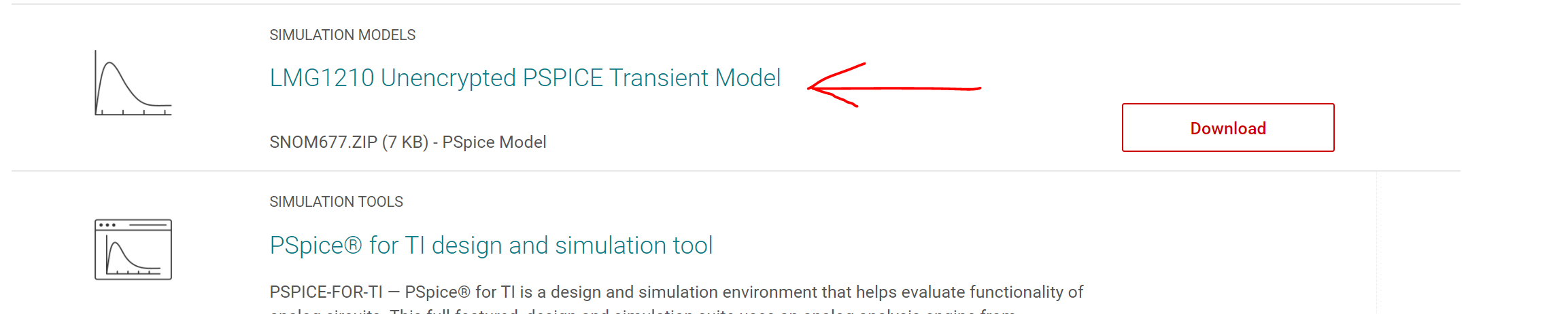

  • Hello Christian,
    Thanks for your patience.
    Can you please confirm that you're using the unencrypted version shown below?
    I have reviewed the simulation schematic and from the looks of it, VSS_0 and VSS_1 are floating whereas these pins should always be the GND reference point. Can you please update schematic with decoupling capacitor on VCC pin similar to TINA-TI reference design? Let's also remove R8 and short HS pins to High-side source. Please re-run simulation to check whether this addresses the issue.
    -Mamadou
