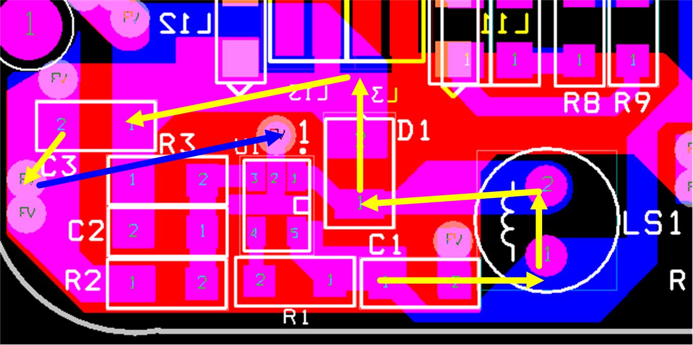

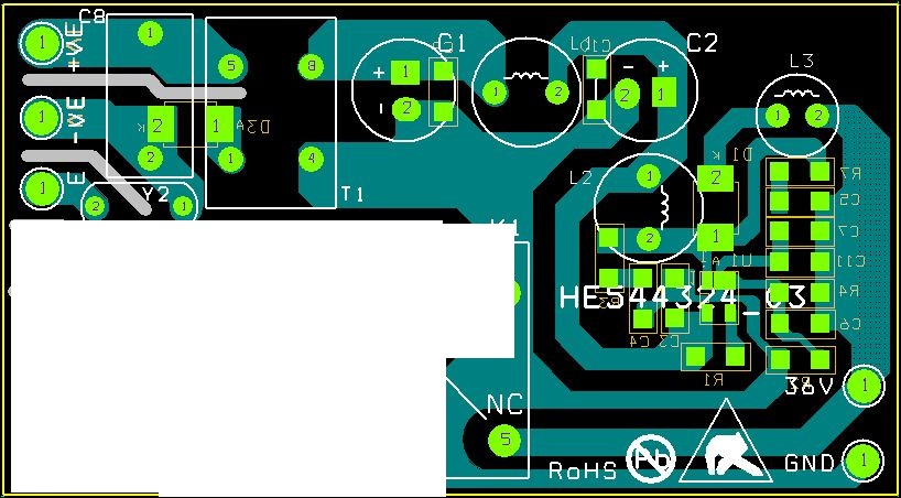

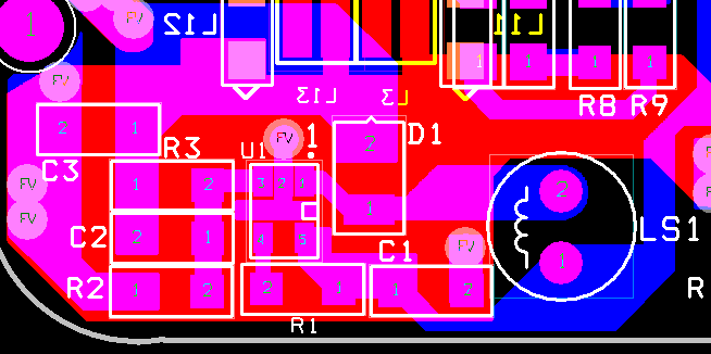

Hi team,
PFA..
We have tested LM2733 board as per reference design by WEBENCH tools.
Results are not as per requirement.
Vin: 12V DC
Vout: 36V, 100mA
Find below results,
When we increase voltage step by step current not increasing as per efficiency.
Vin Vout Iin
9VDC 8.5 25mA
10VDC 9 41mA
11VDC 11 56mA
12VDC 11.5 55mA
13VDC 12 56mA
14VDC 11.5 40mA
Second things when we supply direct 12V DC current gets boosted up to 500mA and IC damage.
Voltage at SW pin 1V.
Looking at components value all as per reference design given by WEBENCH tool.
Kindly comment on the issue and give us solution asap.
Await your positive reply.
Tanvir0636.WBDesign5.pdf
