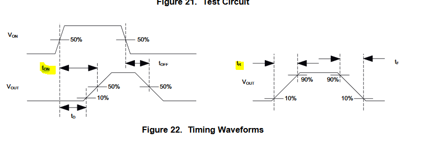

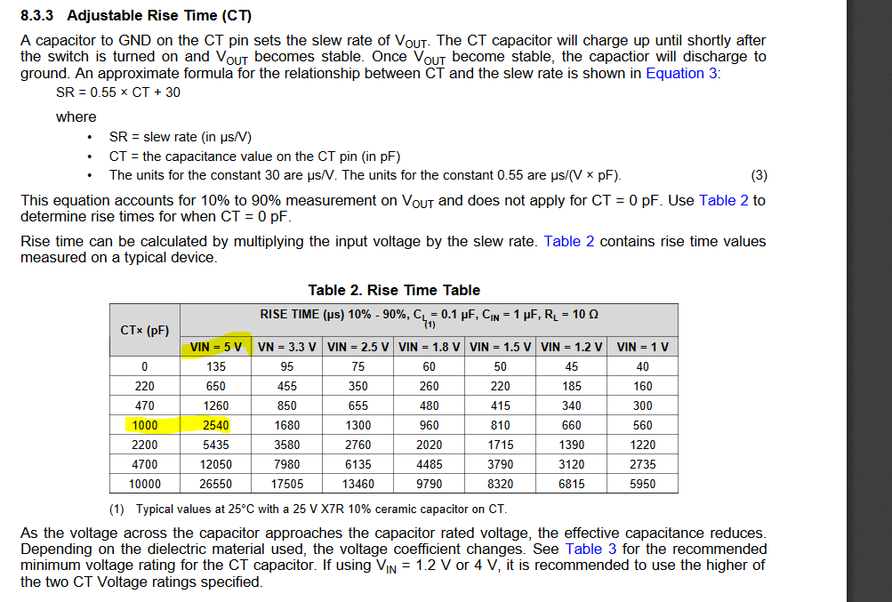

I have one question regarding TPS22918 when I read the datasheet.
what's the difference between Turn on time (Ton) and Rising time (Tr) ?   I think Ton value should be large than Tr , but it's opposite in the TPS22918 datasheet.
Can you give a waveform or picture to explain ? Thank you so much !
