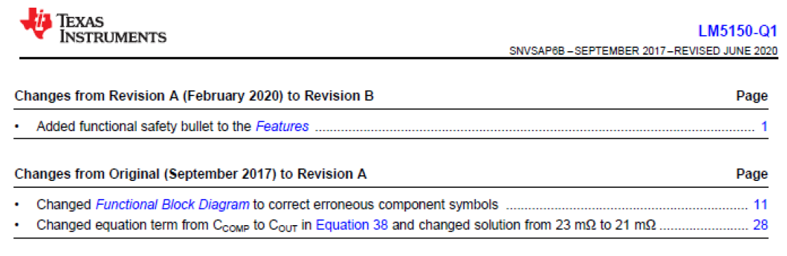

Could you tell us about the contents of PCN of LM5150-Q1 issued this time?
(question 1)
Looking at the contents of the PCN, there are the following. Does the corresponding part of the PCN include both the first edition to revision A and revision A to revision B?
(Question 2)
Changes from revision A to revision B. Originally, this device had functional safety support, but it was added because the description was not in the data sheet?
Or did you add it to the data sheet because it was functionally safe this time?
It seems that the application report snva969 was published in June 2020. Is this report related to the content of this PCN?

  • Hi Kaji@Pan
    From the original to the version of the datasheet to the A revision there were some equations that were changed but there was no change to the functionality of the LM5150. I believe that this is the PCN that you were referring to.
    From revision A to revision B the functional safety-capable bullet was added. The data that supports that bullet is in SNVA969 as you mentioned. This is not connected to the PCN but is just and addition to the datasheet.
    Garrett
