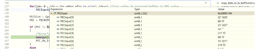

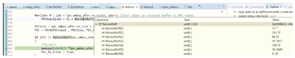

    Please find the attachment. In the attached example I am reading dataflash value from address 0x44D3.
    There are three attachments,
    1. Sequence of PEC Input buffer for calculating the PEC
    2. Rx buffer the data received from data flash through manufacturing block access (0x44) read command

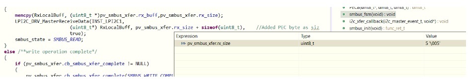

    3. Receive Buffer size,
    In the attach example the length I get is 34 even though the rx size is 5. I am not sure how/why it is sending 34 as length every time while reading from dataflash.
    I need your help in calculating the PEC with received data. In Rxlocalbuff[5] I think PEC is received from GG as 16.
    Note: The value observed in the images are in decimal
  • Hi Shreyas,
    I checked and I see what you are talking about. In the TRM, reading from data flash is a 32 byte block, that is why the length is 0x22 (2 bytes for flash address and 32 bytes for data). The comes after the 32 bytes and it is correct.
    For example, I powered up the BQ78350-R1 with default settings and changed the serial number to 0x1111. Then I read this from data flash:
    16 44 17 22 6D 40 11 11 11 54 65 78 61 73 20 49 6E 73 74 72 75 6D 65 6E 74 73 20 20 20 07 62 71 37 38 33 35 30 20 33
    (where 0x33 is the CRC)
    Matt
  • Hi Matt,
    Does it mean we can only calculate the PEC only by reading the length of 32 bytes at a time from dataflash ?
    Shreyas Shroff
  • Hi Shreyas,
    Yes, the PEC is calculated at the end of the read transaction. Data flash reads are 32-bytes according to the TRM.
