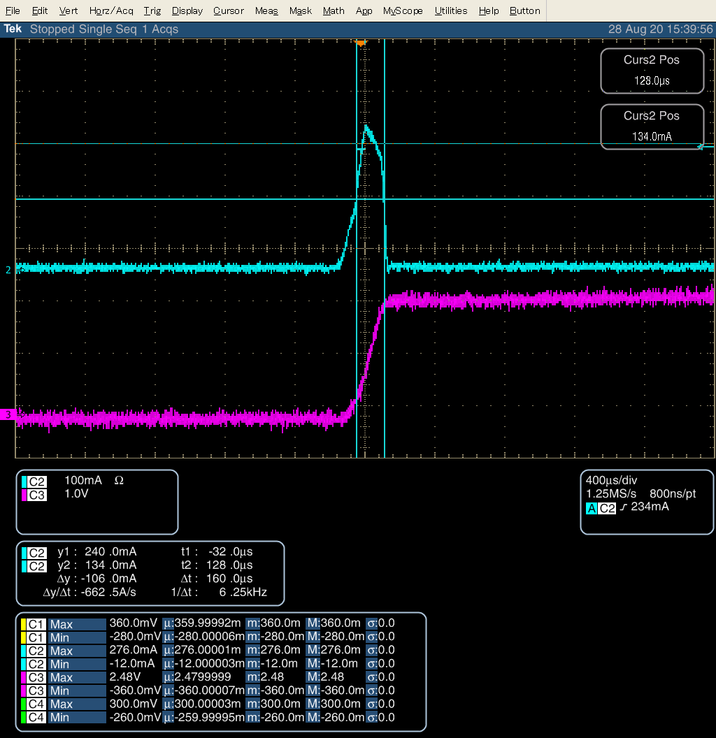

3.3V is converted to 2.5V using the device of TPS73125DBVT.
As for the circuit configuration, 3.3V power supply is connected to 1pin and 3pin, 0.1uF capacitor is bypassed to 4pin, and 2.5V of output is connected to 5pin.
When the power is turned on, a blue waveform current flows to pin 5.
As you can see, the current flows from 130mA to 240mA to IOUT for about 160us. Can this damage the parts?
