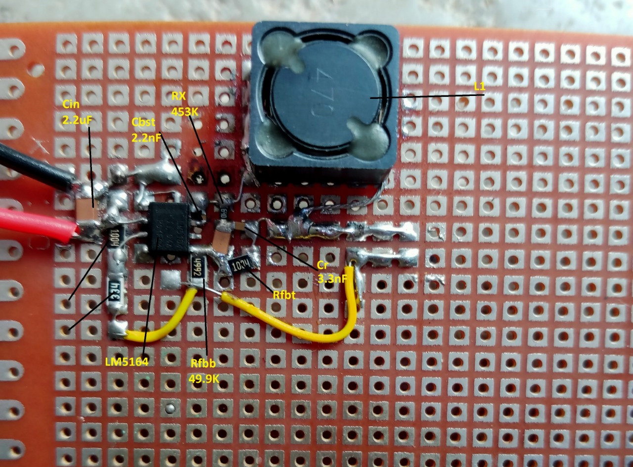

I am muralikrishna from Innolia Energy. I am using LM5164 IC in my design but i am facing some issues with this. Below changes made in the circuit and below are the observations.
1) Placed 68uH/1.3A inductor By using this IC has burn out.
2) Placed 68uH/2A inductor, i was getting 12V output but there is lot of noise and gradually the out has been decreased.
3) Placed 47uH/2.35A, now i am getting 4V output but there is lot of noise.
Attached schematics. Please help me out of these issue.
