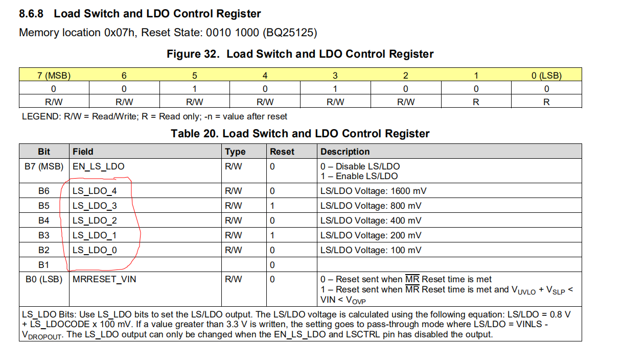

CCS/BQ25125: Load Switch and LDO Control Register B2-B6 can't Set!
Part Number: BQ25125
     I set reg 0x7 0xFC  b2-b7 all one, but read 0x7 get value is 0xA8. I can't know why?  LS/LDO pin voltage can't change. LSCTRL pin has input high level.
     but set reg 0x6 0xFE, read 0x8 value is 0xFE, SYS pin volatge is change correct.
