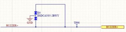

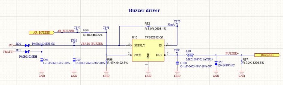

I would like to know if there is any action could improve the ESD performance of TPS92612-Q1 output pin.
They would like to pass the ISO 10605 +/-15kV for contact and air. I understand this is system level ESD spec. So they have added the ESDCAN05-2BWY on the output pin. The schematic and layout are showing as below.
But the output pin still fail when do the ISO 10605 test. Do you have any idea for this issue? or whether we could do anything on output pin to improve the ESD performance?
